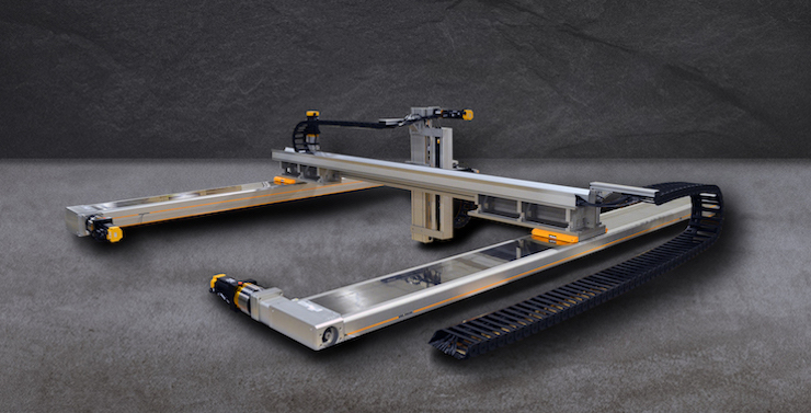

gantry
Sizing and selecting the best mechanical solution for an application, especially where multiple axes are required such as in gantry systems, involves many design details and components, including encoders and sensors.
