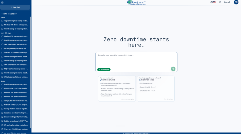

Software Toolbox designed jonjon.ai as an AI co-pilot and agent for the controls engineers, automation specialists, and system integrators who keep industrial systems connected, commissioned, and running. Its focus is the connectivity layer — programmable logic controller (PLC) drivers, industrial protocols, supervisory control and data acquisition (SCADA) and historian links, and edge-to-cloud data flows. In fact, jonjon.ai troubleshoots protocols including OPC UA, Modbus, EtherNet/IP, BACnet, DNP3, IEC 61850, MQTT, and MTConnect (as well as Allen-Bradley ControlLogix and Siemens S7 PLC families) across the 140-plus drivers in the Software Toolbox ecosystem.
So how does jonjon.ai keep its answers specific to industrial connectivity? The software uses retrieval-augmented generation (RAG) to ground its step-by-step answers in more than 1,500 Software Toolbox knowledge articles and decades of the company’s industrial connectivity experience. The engineer can type a natural-language question or upload a log file, SCADA alarm screenshot, PLC error screen, diagram, or configuration file (with images and text files to 10 MB) and get back likely causes, corrective actions, and the next diagnostic checks to run. That spares the engineer from retyping long alarm strings or combing through manuals, support tickets, and tribal knowledge in the middle of a production issue.
The jonjon.ai interface accepts a plain-language description of an industrial connectivity issue along with an attached log file. Getting-started prompts and software migration guides (such as TOP Server V6 to V7 and OPC Router v4.x to v5.0+) appear below the entry field. Image: Software Toolbox
What’s more, jonjon.ai works in 11-plus languages (including English, Spanish, Mandarin Chinese, Arabic, French, and Swedish) and preserves protocol names and industrial terminology in each. Unified namespace (UNS) integration gives the software plant-specific context such as equipment hierarchy and MQTT topic structure. jonjon.ai can also generate custom migration guides and keep a persistent record of past troubleshooting sessions. That in turn supports shift handoffs and multi-day commissioning efforts.

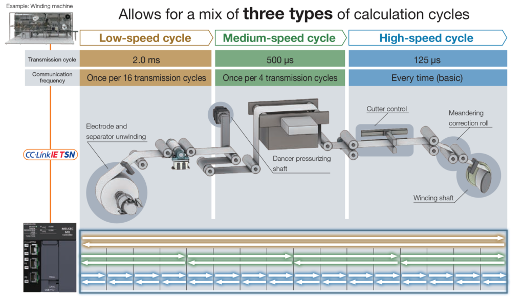

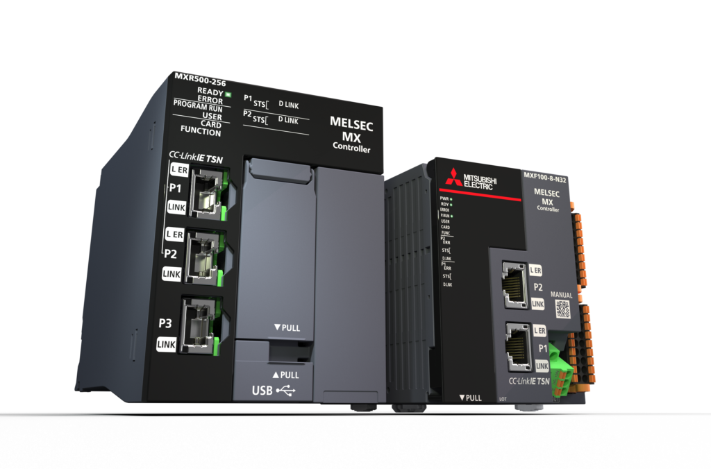

The MELSEC MX Controller from Mitsubishi Electric is a programmable automation controller (PAC) that integrates sequence, motion, and network control into a single module. Inside is a multi-core microprocessor unit (MPU) that executes sequence, motion, and network tasks simultaneously on three independent processing cycles. That lets the MX Controller replace the PLC-plus-motion-controller combinations common on complex machinery — and reduce engineering overhead, cabinet space, and system latency in the process.
The MELSEC MX Controller family includes the MX-R model (left) for motion control of up to 256 axes and the compact MX-F model (right) for up to 16 axes. Both have built-in CC-Link IE TSN ports. Image: Mitsubishi Electric Automation
Built-in is CC-Link IE TSN for time-sensitive networking. This integrates control and information transmission on one deterministic, high-speed network. It also supports multiple communication and control cycle times at once, so high-speed and low-speed axes run together without compromising determinism.
Consider a winding-machine application: One MX Controller can handle low-speed (2.0-msec), medium-speed (500-μsec), and high-speed (125-μsec) cycles across functions such as electrode and separator unwinding, dancer pressurizing, and cutter control.
There are two models:
  • The MX-R model handles motion control to 256 axes, connects to as many as 253 stations, holds programs to 80 MB, and works with iQ-R series base units, power supply modules, and many other iQ-R modules.
  • The compact MX-F model handles motion control of up to 16 axes with 12 MB of program capacity and supports up to 30 general stations, so its drive system can include servos on as many as 46 axes.

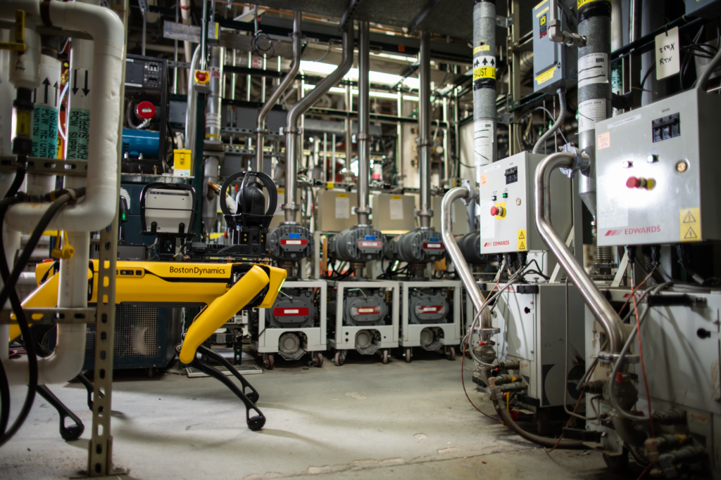

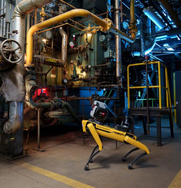

Boston Dynamics built its quadruped robot Spot to handle routine inspections in tough industrial environments, and the robot’s foundational design lets it navigate human spaces naturally, safely, and autonomously. The winning entry centers on Orbit (the fleet software that manages Spot) and Spot’s new 5.1 software release. Together they add AI-powered image analysis, remote inspection authoring, and new sensing hardware.
Spot can now autonomously patrol a facility and capture images at various points of interest. Orbit then analyzes those images with AI-powered vision-language prompts to flag issues such as spills, missing fire extinguishers, or equipment wear and tear. Mission setup is simpler, too. Previously, an operator had to physically walk Spot through a facility to program a new route. Now Site View Inspection Authoring lets a manager open a live digital map of the workplace, click any location, and remotely assign a new inspection task (such as checking a gauge or scanning for an air leak). Site View also provides a visual record for monitoring conditions over time, and a centralized dashboard manages multiple robots across different sites with customizable user roles and permissions.
Spot carries inspection payloads through industrial facilities on autonomous routes managed by Orbit fleet software. Applications include power substations and utilities, manufacturing and assembly plants, chemical, oil, gas, and nuclear facilities, and data centers. Image: Boston Dynamics
On the hardware side, the new Spot Cam 2 combines a 4K pan-tilt-zoom (PTZ) camera with 25x optical zoom, an integrated radiometric thermal camera for mapping temperatures, and a 360° spherical camera for full situational awareness. Eight adjustable LED lights illuminate pitch-black areas, and an integrated accessory bay accepts acoustic sensors that listen for air or gas leaks. That makes multimodal inspections possible: Spot can listen for acoustic air leaks, map temperatures, and record video of a single target simultaneously.
