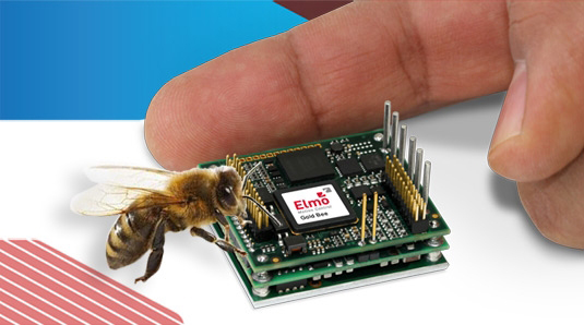

4-Elmo-DW-HALT-servo-drive-testing-0One family of motor drives — tiny ultra-high-current Gold Bee drives from Elmo Motion Control — recently passed highly accelerated life testing (HALT) for accelerated temperatures, electrical cycles, thermal shocks and vibrations.
The tests show that the small servo drive successfully withstands temperatures from -75° to +110° C and easily endures mechanical vibrations exceeding 30 grms.
Gold Bee drives withstood a 48-hour test of exposure to these extreme conditions with zero failures.
