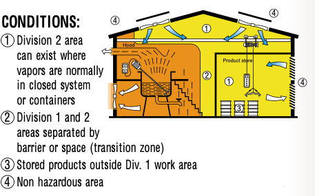

Divisions indicate the probability of the hazardous substance being able to produce an explosive or ignitable mixture based on its presence.
  • Division 1 – Ignitable concentrations of the hazardous substance exist under normal operating conditions and/or where the hazard is caused by frequent maintenance or frequent equipment failure; or where easily ignitible fibers or flyings are handled, manufactured, or used.
  • Division 2 – Ignitable concentrations of the hazardous substance exist under abnormal operating conditions; or where fibers or flyings are stored or handled other than in the process of manufacture.
For example, a Class I, Division 2 location is one where flammable gases or vapors may be present, but where ignitable concentrations exist under abnormal operation conditions (not under normal operating conditions or due to frequent maintenance or equipment failure).
hazardous locations - Class/Division classification
This example shows areas classified as Class I, Division 1 (orange) and Class 1, Division 2 (yellow) hazardous locations.
Image credit: EGS Electrical Group
