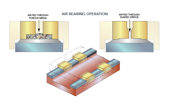

Systems with reduced contact and friction: Air bearings are another option (albeit relatively uncommon) for guiding and supporting loads. In cleanrooms, air bearings excel because they are completely noncontact. Another completely noncontact component is linear motors.

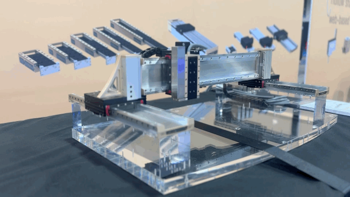

A linear-motor stage with air bearing guides in theory has no friction and so no particle generation.
In real-world installations though, moving cables and cable carriers can generate particles. So, some cable manufacturers offer products with special low-friction coatings to minimize particle generation; cable tracks with abrasion-resistant joints can also help reduce wear between sections.
One such make of these air bearings integrates them into both linear and rotary bearing slides, XY air bearing tables, rotary tables and spindles, and tip-tilt stages. Also on offer are three-degree-of-freedom spherical air bearings.
A solution to the problem of particle generation due to friction is to use noncontact components and systems. For example, some linear-motor stages have air bearings. The cable can be a flat self-supporting type that doesn’t need a cable carrier.
Air-bearing guides complement multi-axis stages with noncontact movement of loads.

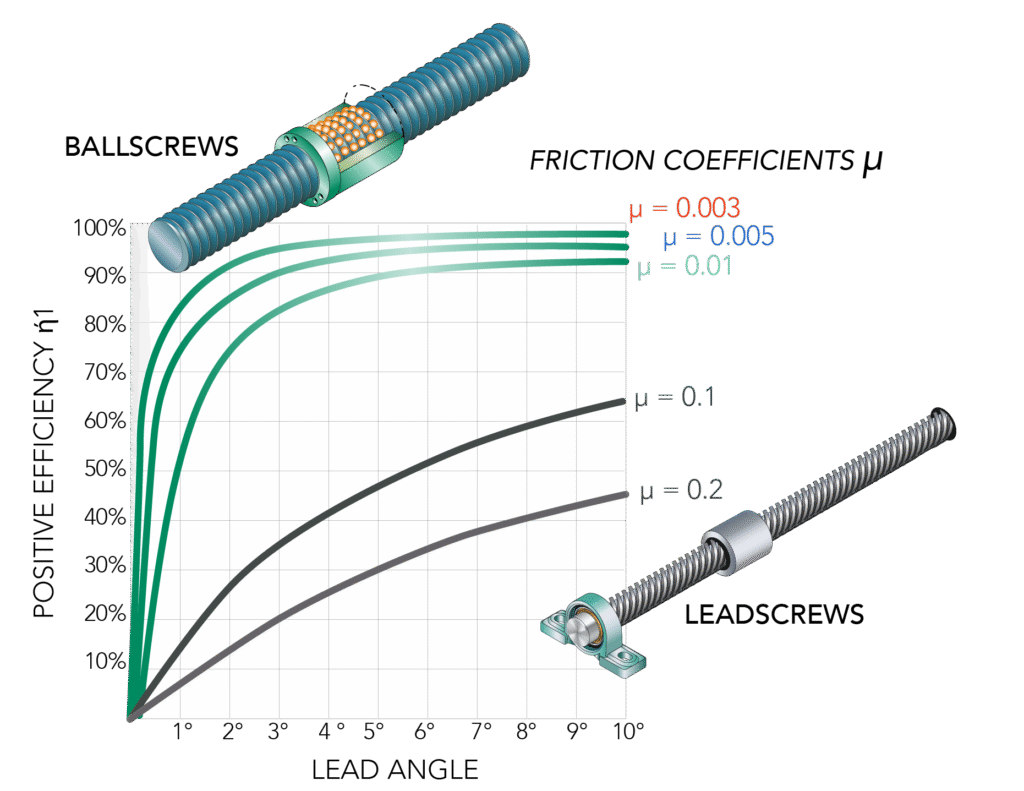

All this said, ballscrews are typically the default choice for linear drives in cleanroom applications. Of course, ballscrews need lubrication and screw rotation can cause lubrication splatter. Here again, low-friction or noncontact seals help keep lubricant inside the ball nut and protect the cleanroom.
We’ve touched on the noncontact nature of linear motors. But common linear-motor arrangements operate with the forcer (primary part) moving. So cables move as well … and in fact, cables are another source of particle generation. So, sometimes a better configuration for cleanroom applications is to keep the forcer (primary) and cables stationary, while allowing the magnet track (secondary) to move.
