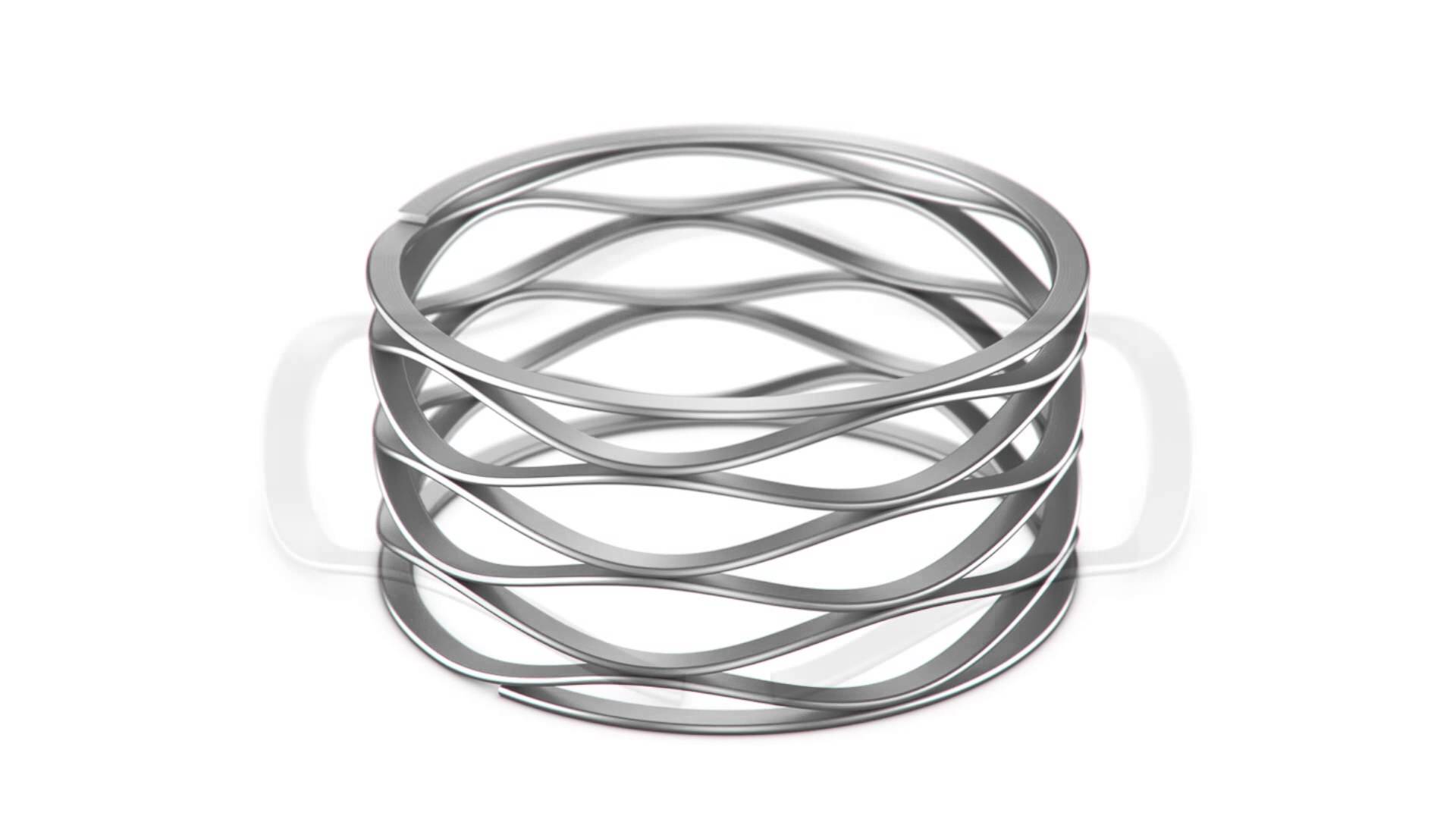

Updated November 2018 || Springs are flexible mechanical components to store and release energy or apply and release forces on machine axes. Wave springs combine flat (non-coiled) bow springs (as their waves) with traditional compression-spring coil geometry. For the design’s compactness (as a high force-to-work height ratio) and other benefits, some motion systems have migrated from traditional helical or coil springs to flat-wire wave springs.

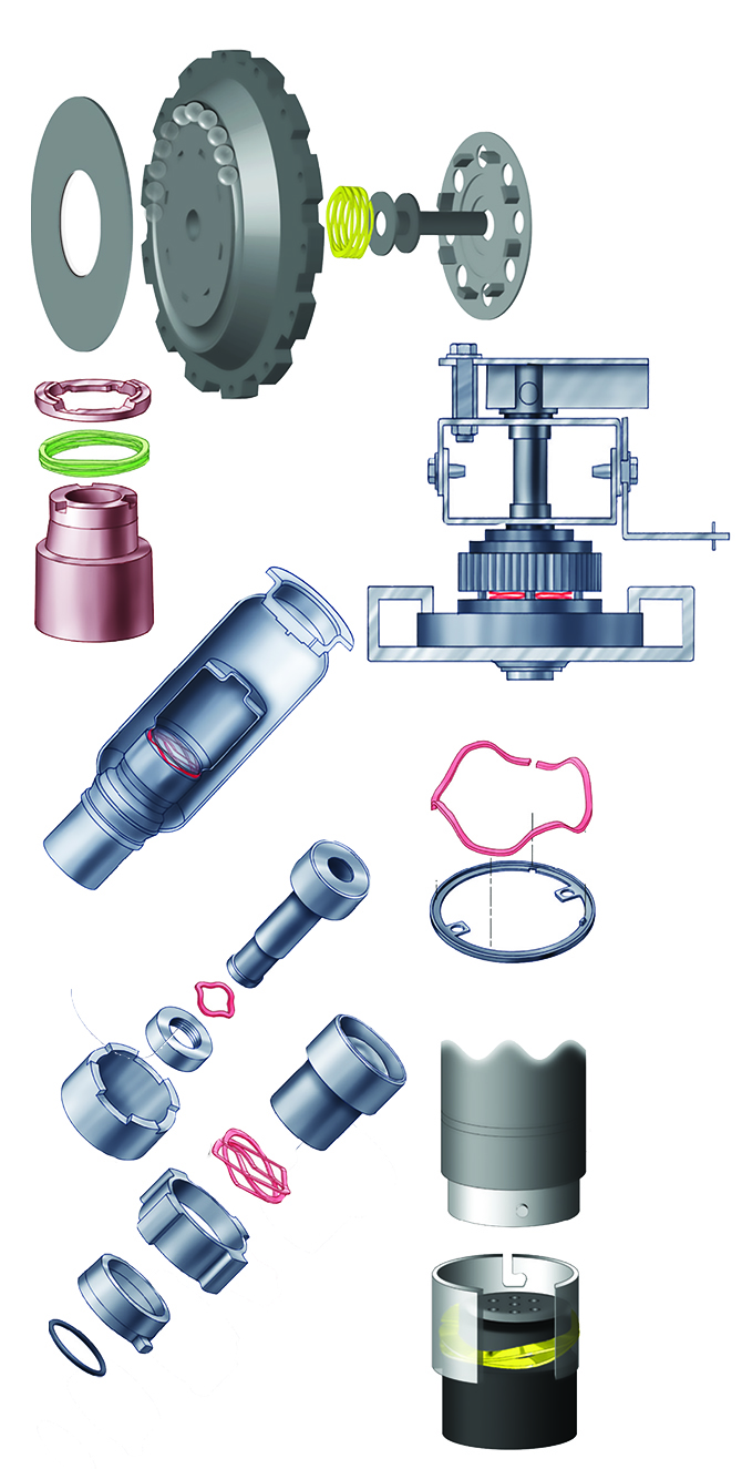

Shown here are wave-spring application examples. From top to bottom, these include clutches, automotive vehicle mirrors, rolling doors, airbag inflators, water sprinklers, general airbag assemblies, night-vision lenses, and bayonet connectors. Image courtesy Rotor Clip Company Inc.
