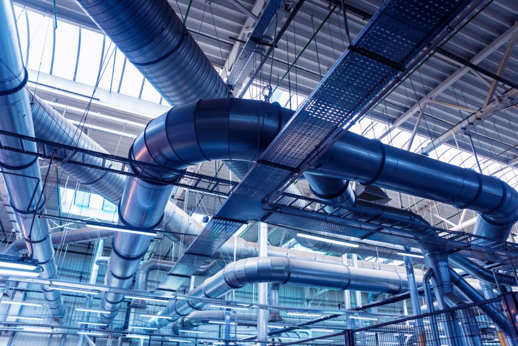

In any HVAC (heating, ventilation, and air conditioning) system, dampers are used to regulate airflow inside the ducts. In some systems, manual dampers allow personnel to turn a handle on the outside of a duct. But if you have to regulate airflow on a constant basis, you’ll need automatic dampers with electric or pneumatic motors that can be controlled by a thermostat or building automation system.

commercial HVAC system
An HVAC system in a commercial building

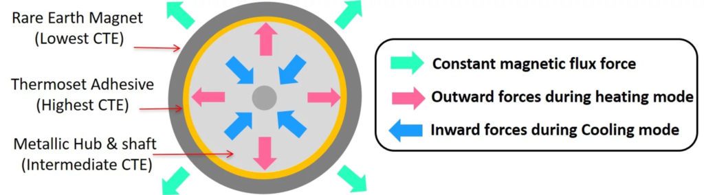

Rotor design for extreme temperatures and cyclic load
For custom stepper motors used with damper actuators in HVAC applications, rotor design is critical. Within the damper actuator, the motor will start and stop under varying thermal conditions, putting additional thermo-mechanical stress on the rotor and other internal components. The nonlinear material used in rotors must have certain thermal properties — especially belonging to the coefficient of thermal expansion (CTE) — to operate reliably in extreme temperatures.
stepper motor damper actuator
Stepper motor cross-section
Choosing linear and nonlinear material-based assemblies can be challenging because the performance of nonlinear materials, like adhesives, depends on material chemistry and processing parameters. In addition, certain ceramic magnet grades makes the decision even more difficult.
stepper motor rotor forces
Forces that act on the rotor assembly

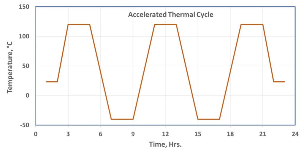

Be sure to validate your design by verifying its performance in the field under static environmental conditions like temperature and humidity or specific load conditions. The material scheme you chose already considers these conditions. However, their performance at dynamic conditions that could involve rapid temperature, humidity or sudden load changes, or combinations of multiple factors, must be validated via simulations or analytical testing to determine the motor’s long-term performance.
For example, at Portescap we validate rotor assemblies at accelerated temperatures and thermal shock conditions in environmental chambers and ovens to confirm that a rotor assembly will meet the application’s extreme requirements. We also conduct axial and torsion force tests to determine rotor mechanical strength at a specific temperature requirement, as well as accelerated life testing to predict a motor’s service life in its application under specific test conditions. The tests are performed under loaded and unloaded conditions depending on the application requirement.
Accelerated thermal cycle of a stepper motor
