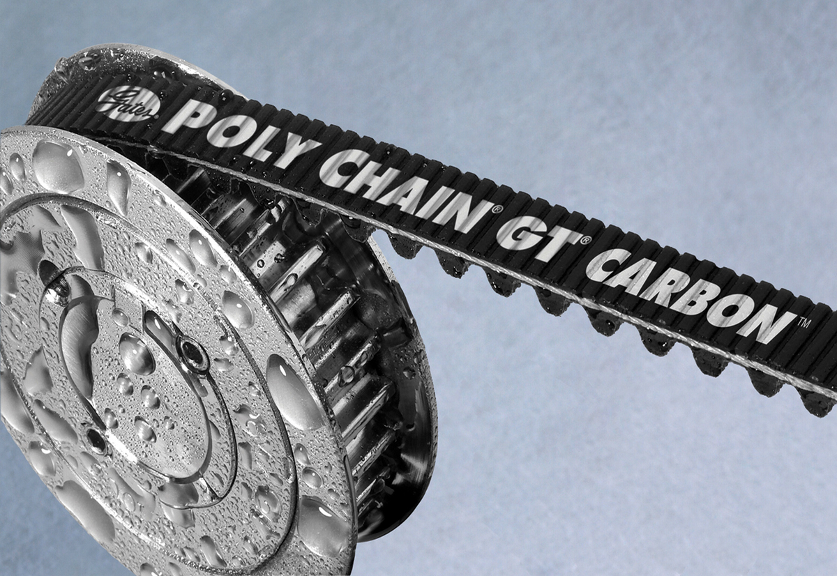

2B-belts-Gates-sprockets-carbon-reinforcementIn addition, the tensile members of today’s belts—cords embedded into the belt rubber that carry the majority of the belt load—are stronger than ever. Made of polyester, aramid, fiberglass or carbon fiber, these tensile cords make today’s belt drives thoroughly modern power-transmission devices.
2A-belts-Gates-carbon-fiber-innovation
Shown here is a Gates Carbon Drive CDN system—lower in cost for new bike applications. It leverages new materials and geometries, with nine carbon cords embedded within engineered polymer belt and an 11-mm tooth pitch profile for lower tension. It replaces chain drives.

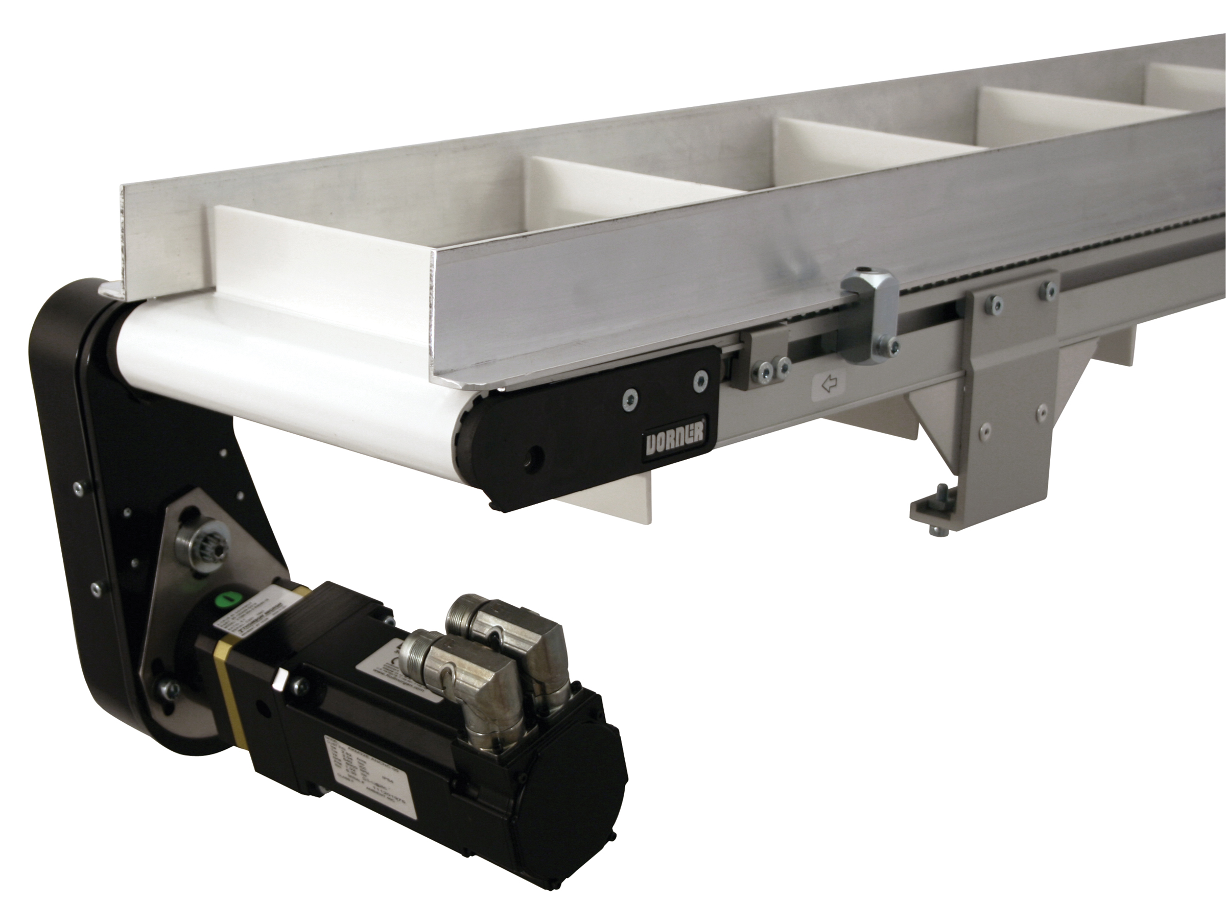

5-Dorner-2200-Timing-Belt-integrated-drive
This conveyor—a Dorner 2200—uses an integrated timing-belt drive to accurately move hundreds of pounds of product at hundreds of feet per minute. It leverages the main benefit of timing belts, which is precise moves.
Dusty environments do not generally present serious problems as long as the particles are fine and dry. In contrast, particulate matter can act as an abrasive and accelerates belt and pulley wear. Debris should be prevented from falling into belt drives. Debris caught in the drive is generally either forced through the belt or makes the system stall. In either case, serious damage occurs to the belt and related drive hardware.
