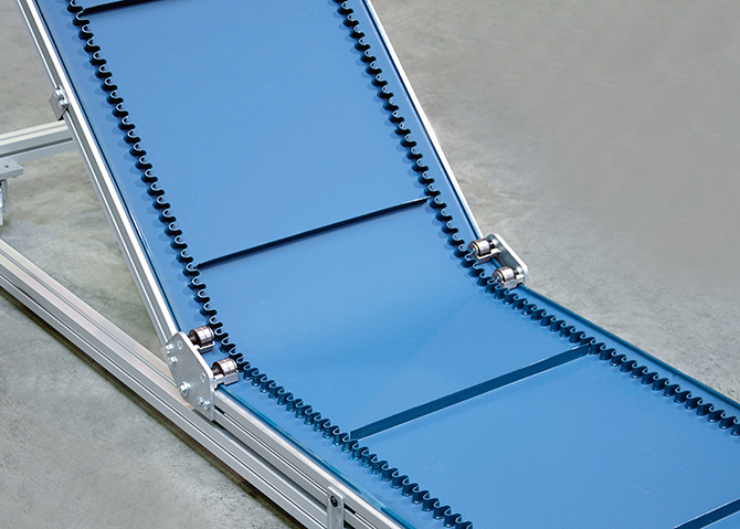

Synthetic belt conveyors as on this horizontal incline conveyor can be outfitted with corrugated sidewalls that act as side rails and contain product on the width of the belt. This belt also has cleats for aiding product upward on inclines.
