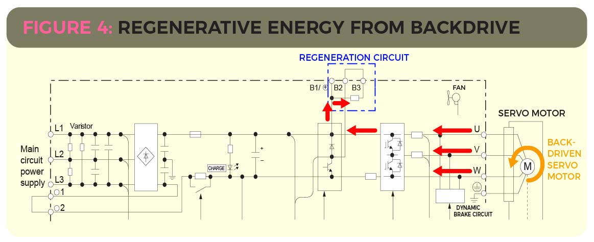

Shown here are a couple examples of where regeneration is helpful — where gravity and tension come into play.
What is regenerative energy?
In a servomotor system under the control of a digital servo amplifier, when the output torque of the servomotor is opposite the direction of the shaft rotation, the motor acts as a generator … and the resulting energy flows back into the drive. The energy returned to the drive is regenerative energy. Three examples of when regeneration occurs during motor operation are decelerating a moving load; lowering a vertical load; and an overdriven nip roll.
Shown here is how Yaskawa’s networkable Sigma-7 Series Servopack digital amplifiers can handle the energy from a backdriven motor.

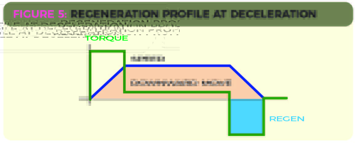

That leads to the next question — what is regenerative resistor braking? Here, regenerative energy is returned to the drive during deceleration because the motor must apply torque opposing the rotation’s direction to stop the load.
For example, when lowering a load without a counterweight, the force of gravity drives the load down, and the motor must apply torque opposite the direction of downward rotation to control the load.
Shown here is a sample regeneration profile upon axis deceleration.
Likewise, in the case of an overdriven nip roll, the motor must apply torque opposite the direction of rotation. In both cases, regenerative energy returns to the drive. Whenever regenerative energy returns to the digital servo amplifier, the bus capacitors absorb the energy … and the dc bus voltage rises.
Of course, if there’s a large amount of energy, the energy must dissipate to protect the drive. A braking transistor turns on to let current flow from the bus through a braking resistor. This process is known as regenerative resistor braking.
Digital servo amplifiers from some manufacturers have built-in resistors to dissipate some regenerative energy … though if the amount of regenerative energy processed by the built-in resistor is exceeded, the design will need an external regenerative resistor.
