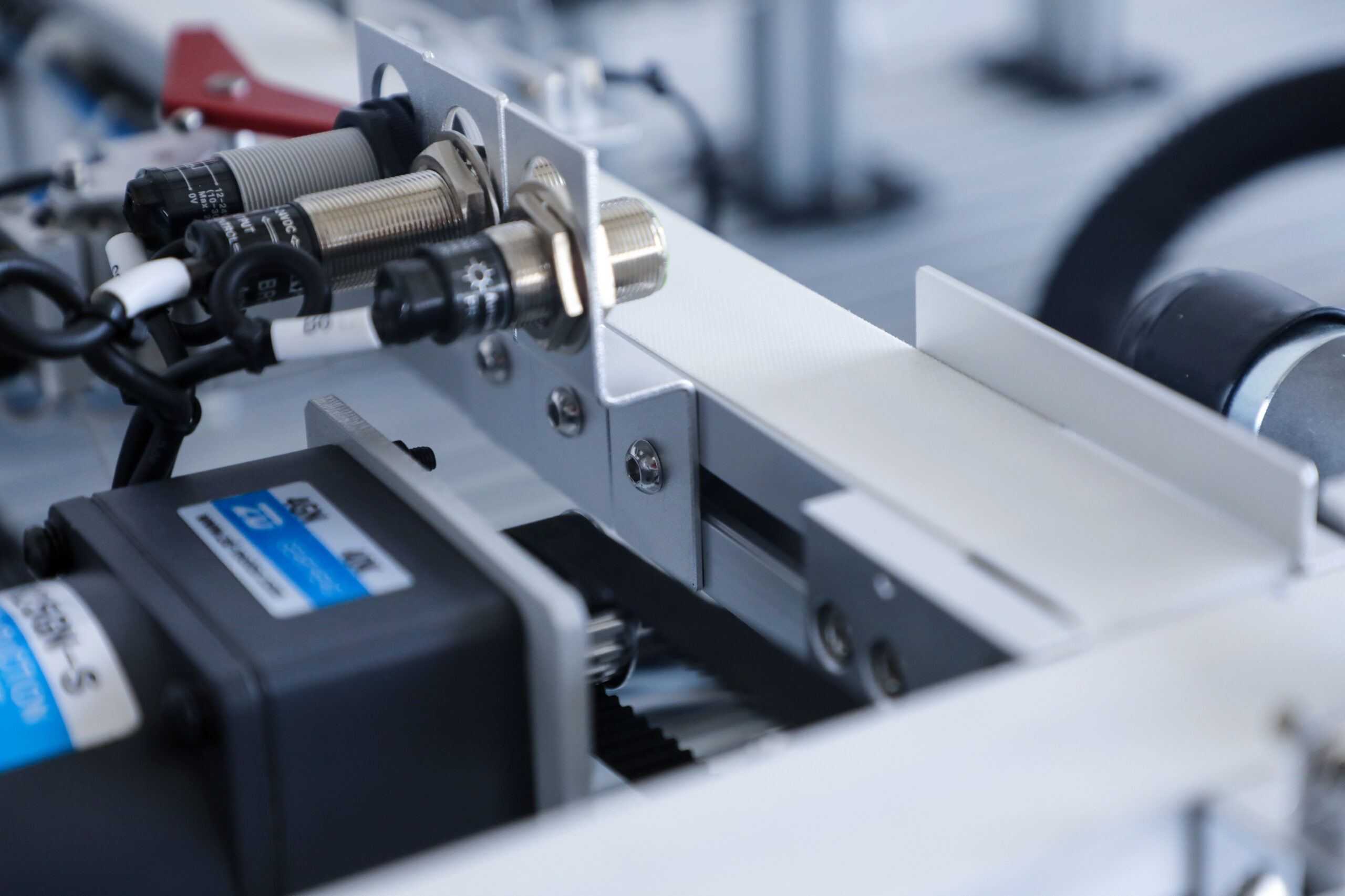

Here, proximity sensors continuously monitor a workcell zone to detect workpieces … and then transmit actionable data to a central controller. This controller in turn dynamically commands motor drives to adjust conveyor belt speed and trigger mechanical sorting arms. Image: Adobe Stock
