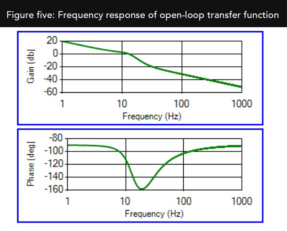

When we multiply the two transfer functions — including the plant G(s) and controller K(s) — we create the open-loop transfer function K(s)G(s) as shown for our EXAMPLE in Figure five: Frequency response of the open-loop transfer function. The open-loop frequency response is an important visual aid for phase margin and gain margin, which are the indicators of system stability.
From the expression of the closed-loop transfer function H(s) we see that when the open-loop transfer function K(s)G(s)= -1 (meaning output signal X is a mirror image of the reference signal Xr) the denominator of H(s) becomes zero and the gain of the closed-loop transfer function goes to infinity … and makes the system unstable. The physical meaning of this expression is that when an output signal X has a -180˚ phase angle with respect to the reference position Xr — meaning that it is a mirror image of the input reference signal Xr — it enters the controller with a (-) sign, which adds another 180˚ to it.
The result is a total of -360˚ phase lag that puts the output signal X in phase with the reference signal Xr and therefore act as a positive feedback. This positive feedback tends increase the position error instead of reducing it —potentially making the system unstable. To become unstable, the feedback of actual position X needs to be positive, but it also must be equal or greater than the reference signal Xr with a gain equal or greater than 1. In this unstable condition, the servo controller pumps in external energy to the system that continuously increases the oscillation amplitude of the stage.

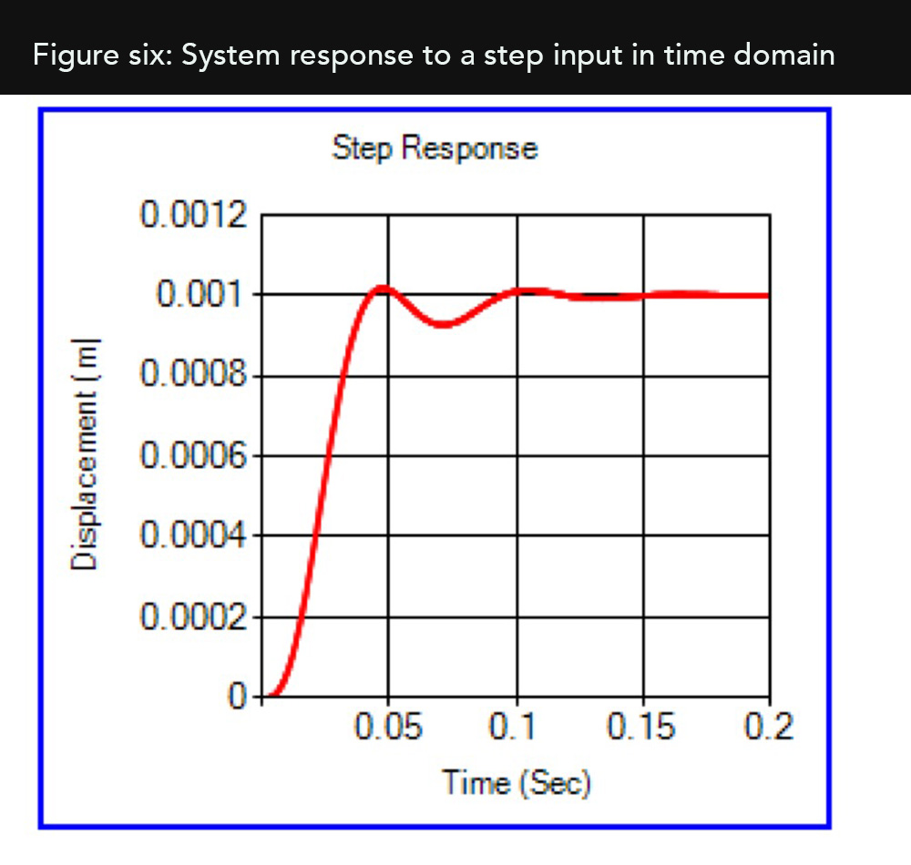

If we look at the response to the step input in time domain as shown in Figure six: System response to a step input in time domain, we see an oscillatory yet stable profile. If we then look at the open-loop frequency response, as shown in figure five, we see that the phase angle, which corresponds to a gain of 1 (0 dB), is equal to about -130˚.
Click to enlarge.
The difference between -130˚ and -180˚, is +50˚. This is a safety margin to stability, which is called Phase Margin. It measures the angle, from the phase at an open-loop gain of 1, to the -180˚ line, which make the system unstable. Servo systems are typically tuned to a phase margin of 30˚ to 40˚.

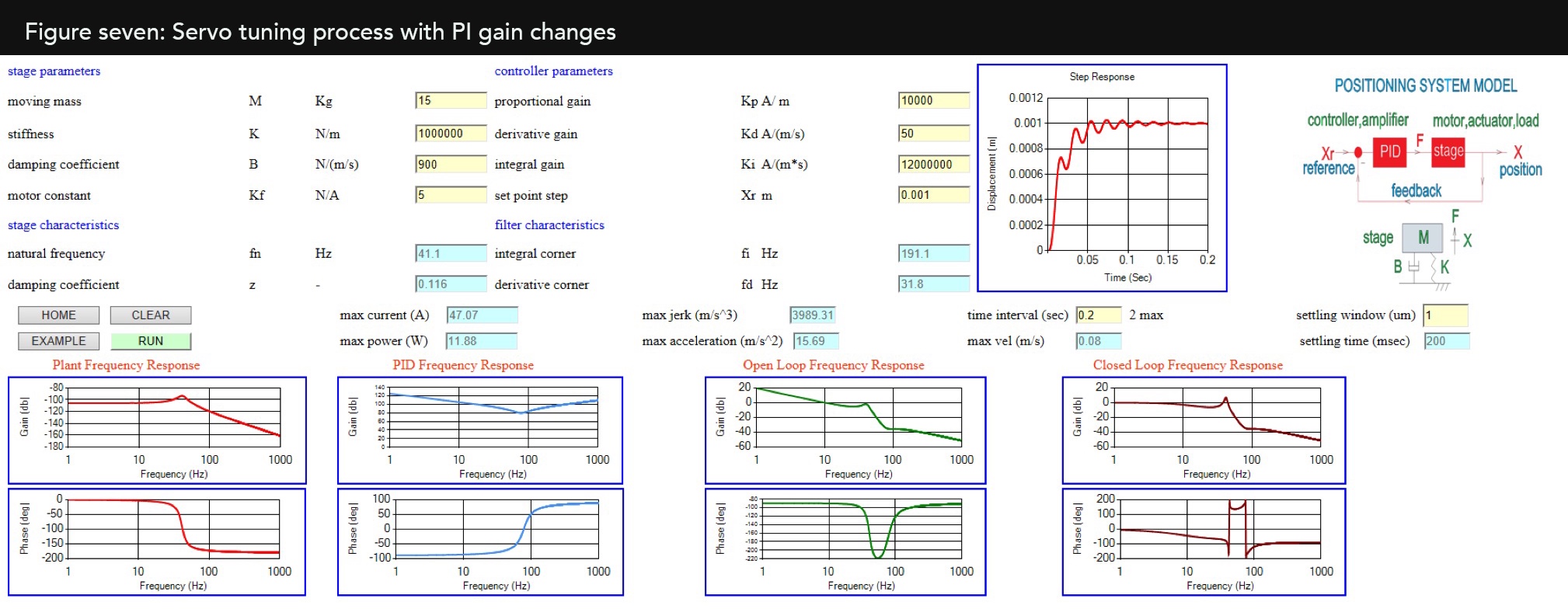

To increase the low-frequency gain (which was lost in the previous iteration) we may try to increase the integral gain Ki by a factor of 10 (by adding a 0 to the integral gain value Ki and clicking RUN). Results in Figure seven: Servo tuning process with PI gain changes show the left side of the trough increased, bandwidth went back to about 10 Hz, and the resulting response became faster yet oscillatory.

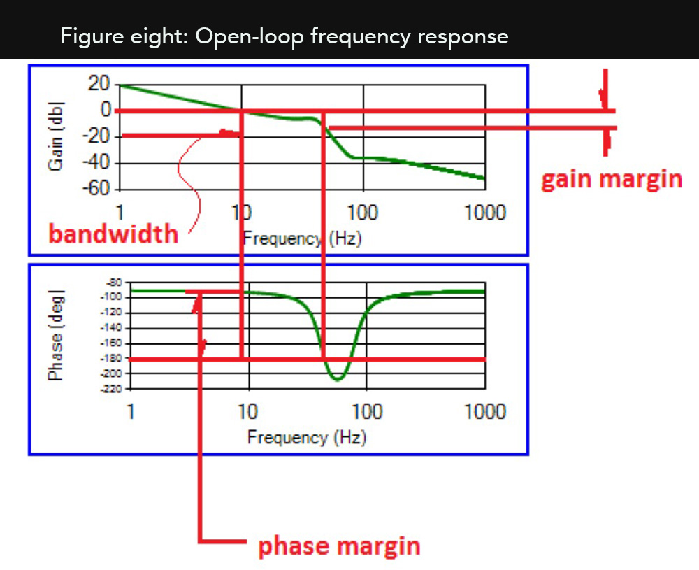

In the last tuning example, we reached a bandwidth of about 10 Hz with a 90˚ phase margin. As mentioned, this is one condition to ensure system stability. Another condition for stability is gain margin — the distance (in dB) between the zero-dB line and the open-loop gain curve at a frequency where the phase is -180˚. Figure eight shows it to be about 15 dB, which occurs at about 80 Hz. The chart in figure eight also shows the phase margin and the bandwidth as discussed earlier.
Shown here are corresponding labels of phase margin, gain margin and the position bandwidth.
The rationale of the gain-margin requirement for stability is like that of the phase margin. When the phase is -180, we need to ensure that output is lower than the input with a gain magnitude of less than 1. Otherwise, the servo will command the motor to add increasing energy to the system, which increases output indefinitely — and makes the system unstable.
Under such conditions, any small noise (such as RFI, EMI, or small floor vibrations) may run the system unstable. Results may be noticeable as loud audible noise, high vibration, and (at high enough gain and low enough damping) a possible catastrophic failure. Servo systems are typically tuned to gain margins greater than 15 dB.
