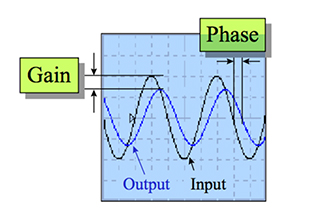

For a system driven by sinusoidal inputs, such as a servo motor, frequency response is a measure of the amplitude and phase of the output signal relative to the input signal. It is a useful estimate of the limits of servo tuning that will produce a stable system without oscillation.
To determine frequency response, a sinusoidal input with controlled amplitude is applied to the system. The output will be a sine wave with the same frequency. As the input frequency is increased (with amplitude remaining constant), the amplitude and phase of the output signal are measured and compared to the amplitude and phase of the input.
Frequency Response
Frequency response represents the gain (amplitude difference) and phase (time shift) between input and output signals.
Image credit: Kollmorgen
In an ideal system, where output perfectly tracks input, the output will have the same amplitude (0 dB amplitude gain) as the input and there will be no phase lag (0 degrees) between the input and output signals. This is referred to as a frequency response function (FRF) of 1. But in real-world applications, there is an input frequency at which the output signal cannot keep up, causing the amplitude of the output to diminish and phase lag to increase.
