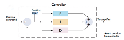

Servo tuning
Each of the PID values acts independently, but their outputs are summed to create a PID output signal.
Image credit: Performance Motion Devices, Inc.
Servo tuning can be achieved through a variety of procedures, but the most common method is to begin by increasing Kp until the system overshoots the target (the system is underdamped). Then Kd is increased until the system becomes critically damped (a balance between fast response and low overshoot). Next, Kp and Kd are increased to the maximum amounts that maintain a critically damped response.
Once Kp and Kd are determined, Ki is set. The integral gain helps remove the last bit of error from the system, but, unlike Kp and Kd, it should be kept as low as possible to prevent the system from becoming unstable.
