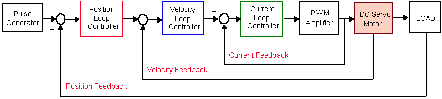

Servo motors operate in a closed-loop system, which includes a feedback device, a drive (amplifier), and a controller. The controller uses output from the feedback device to compare the commanded value (position, velocity, or torque) to the achieved value and issues commands to the drive to correct any errors. This process of monitoring feedback and making corrections is referred to as a control loop. Depending on the application and performance requirements, a servo system can include any combination of three types of control loops: a position loop, a velocity loop, and/or a current loop.
control loop
Servo drives often have a multi-loop structure, with the current loop nested inside the velocity loop, which is nested inside the position loop.

The velocity loop is the most common servo control loop. It compares the commanded velocity to the actual velocity via a tachometer or encoder and issues commands to increase or decrease the motor’s speed accordingly. The velocity loop is also referred to as a PI controller, as it typically uses both proportional gain (Kvp) and integral gain (Kvi) to determine the correction command. The amount of proportional gain is, as its name suggests, directly proportional to the amount of the error, while the integral gain increases over time and is used to “push” the motor to zero error at the end of the move.

For applications that require control of position, a position loop is added “around” the velocity loop in what is known as a cascaded position/velocity loop. The position loop determines the following error, which is the deviation between the actual and commanded positions, and issues velocity commands to reduce or eliminate the following error. In a cascaded system, the position loop typically uses only a proportional gain, Kp.

Current control is needed when the required response time is high, as in the case for many industrial servo applications. The primary goal of the current loop is to control torque, which influences speed, and therefore, position. The current loop is typically nested inside the velocity loop, making current the innermost loop, with the velocity loop in the middle, and the position loop being the outermost loop. Current loops are typically PI controllers, with both proportional and integral gains. Current control parameters are often set by the manufacturer, saving the user the time and effort of tuning the current control loop.

In any cascaded system, the response time, or bandwidth, of the inner loop must be faster than the response time of the outer loop. Otherwise, the inner loop will have little effect on the outer loop. The general rule for nested servo control loops is that the velocity loop should have a bandwidth that is anywhere from 5 to 10 times that of the position loop, and the current loop should have a bandwidth that is 5 to 10 times that of the velocity loop.
In general, higher bandwidth is better, but because the bandwidth of one loop affects the next loop within it, increasing the bandwidth of the position loop causes the required bandwidth of the velocity loop to increase. Similarly, increasing the bandwidth of the velocity loop causes the required bandwidth of the current loop to increase. In both cases, increasing the bandwidth of one loop to the point that the required bandwidth of the next, nested loop is unachievable, does no good for the performance of the system.
