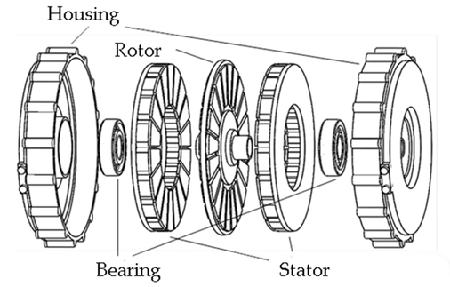

The armature windings of a pancake motor are printed on a disc (hence, the term “printed armature”). The disc is typically made from a non-magnetic, insulating material such as glass fiber, with copper conductors. The armature disc (rotor) is located between two thin stator discs containing permanent magnets. The magnets are arranged with alternating north and south poles so that the magnetic fields between adjacent pairs oppose each other.
pancake motors
A pancake motor consists of a printed armature (rotor) between two permanent magnet stators.

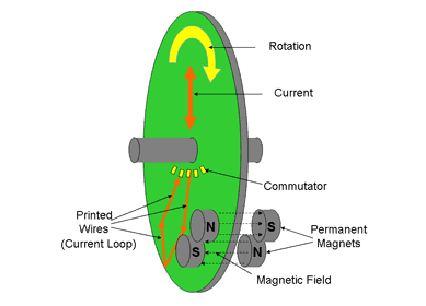

This construction results in an axial air gap, with magnetic flux that also runs axially, along the length of the motor. Current, therefore, runs radially, from the center of the motor to the outer edges, and torque is produced around the axis of the motor, according to the principle of the Lorentz force.
When a conductor with current (the armature) is placed in a magnetic field that is perpendicular to the current, a force is generated on the conductor. The direction of the force is perpendicular to both the magnetic field and the current. This force, known as the Lorentz force, produces a torque that causes the motor to rotate according to the right-hand rule (or, more appropriately for electric motors, the left-hand rule). Because their operation is based on the Lorentz force, rather than on Faraday’s law as with conventional motors, pancake motors are sometimes referred to as Lorentz force motors.

pancake motors
Pancake motors operate on the Lorentz force, which is perpendicular to both the magnetic field and the current. This force produces torque that causes the motor to rotate.

In addition to axial construction, pancake motors have two other unique features: an ironless core and lack of a commutator. These construction principles give pancake motors several performance advantages over conventional cylindrical motors. First, because the armature contains no iron, there is no cogging effect, which is traditionally caused by the magnets in the stator attempting to align themselves with the iron in the rotor. Cogging makes it nearly impossible for conventional motors to achieve smooth motion, and pancake motors are the only motor type with no cogging or torque ripple.
Also, no iron means minimal inductance and no stored energy to be dissipated during commutation, so there’s no arcing of the brushes. Brush wear is a significant drawback to traditional brushed motors, but with no arcing, brush wear is greatly reduced and brush life is improved in pancake motors.
The low inductance of pancake designs also means that they have low electrical time constants, allowing current to flow very quickly into the armature for virtually instant torque production. Peak torque production is also higher in pancake motors due to their lack of iron. In conventional iron core motors, the magnetic field of the armature can demagnetize the permanent magnets, so peak current (and, therefore, peak torque) is limited to just 2 to 3 times the continuous rating. Pancake motors, without iron in the armature and with an axial magnetic field, can withstand peak current up to 10 times the continuous rating, for higher peak torque.
The second unique feature of pancake motors is that in addition to the copper conductors, the commutator is also printed on the armature. This design allows the brushes to run directly on the armature surface. The lack of a separate commutator ring, in conjunction with the flat overall design, make pancake motors very compact, especially when compared to conventional cylindrical motors. Their thin design, along with a low inertia (due to the absence of iron) allows pancake motors to achieve extremely fast acceleration and deceleration.
