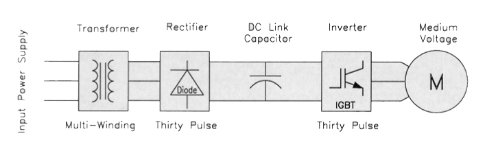

Medium voltage drives can be either current source inverter or voltage source inverter types, although VSI types are more popular due to high reliability and low harmonic distortion. AC drives in this configuration are referred to as medium voltage multi-level voltage source PWM drives.
medium voltage ac drives
Schematic of a medium voltage multi-level VSI-PWM drive.
Image credit: Robert Hanna
Recall that inverters convert DC power back to AC power at the required frequency and voltage. The term “multi-level” refers to the output of the inverter, and PWM is pulse-width-modulation – which switches the DC voltages in order to create the AC power. In the multi-level design, the inverter uses multiple DC voltages (rather than just two voltages, as with a typical 2-level inverter) to synthesize the AC waveform, making it nearly sinusoidal in nature. This allows the PWM switching frequency to be reduced and reduces the dV/dt, which reduces harmonics. Most medium voltage AC drives also include a multi-phase transformer on the front end, which works in conjunction with the multi-level inverter to reduce harmonics. And for applications with highly dynamic loads, an active front end may also be used. The active front end reduces harmonics on the line (input) side by monitoring the harmonic level and actively filtering the waveform to provide dampening.
