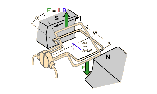

The lever arm for the torque produced on the armature varies with the angle of the coil (cos α). Therefore, when the coil is perpendicular (vertical) to the magnetic field of the stator, no torque is produced. This is why DC motors have multiple coils; so the armature mechanism will continue to experience a force, even when one coil is perpendicular to the magnetic field.
Image credit: Georgia State University

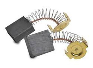

The term “brushes” was coined in the early days of DC motors, when they were made of strands of copper wire. These devices required frequent replacement and damaged the commutator rings. Modern DC motors typically use “brushes” made of carbon, which wear more slowly and cause less damage to the commutator.
