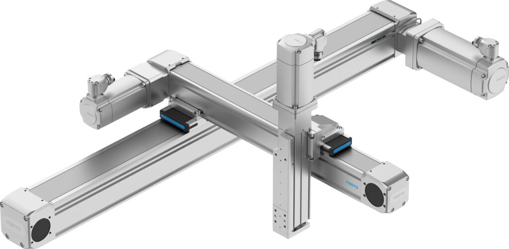

Positioning Systems at Festo Booth 1619: Festo features three different multi-axis handling solutions showing precise positioning with Festo electric tooth belt and ball screw axes in two-axis, three-axis, and cantilevered configurations. These demos showcase how Festo’s diverse product lines — from pneumatic and electric powered grippers to motion controllers and PLCs — seamlessly integrate within handling solutions. In addition to viewing these systems at the Festo booth, attendees can also stop by the Siemens and CODESYS booths to see Festo handling systems in action.
This cantilevered handling system uses Festo ELGD axes. Festo ensures a robust and reliable supply chain for assured availability, and industry leading price-to-performance ratios.
New generation of actuators: At its booth, Festo highlights its next generation ELGD tooth belt and ball screw high moment and load capacity family of axes. These products feature precision, high speed and acceleration, and compact size for smaller footprint machines. The integrated bearing design of the ELGD family enabled Festo to develop a compact-profile ELGD for reduced force applications. The reduced profile ELGD is 30% lighter than larger units with similar rigidity and guide load capacity.

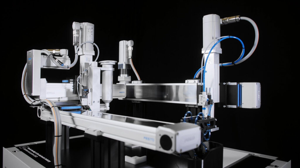

The electric light assembly demo at the Festo booth features a Cartesian handling system, left, for gluing and a pick-and-place handling system, right. The ELGD axes are the centerpieces of this demo.

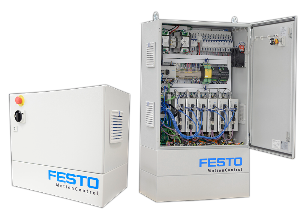

Festo Motion Control Package custom control cabinets: Festo customer solutions operations in Mason provide Festo Motion Control Package (FMCP) custom control cabinets with function block software that reduces startup time for multi-axis systems from weeks to hours. FMCP control cabinets are delivered fully assembled and ready to install. The OEM simply adds power, Ethernet connection, IO, and wiring to the motors.
The Festo Motion Control Package (FMCP) control panel arrives wired and ready for installation. This image shows the full edition cabinet that houses up to six drives, the compact panel houses three drives.
No specialized or manufacturer specific programming knowledge is required. OEMs simply use function blocks to fill in key motion parameters for fast programming. Basic motion can be taught through a web server or IOS/Android app. The Festo Motion Control Package is also PLC independent, which means the OEM or end user can use their PLC of choice, eliminating any additional programming expertise or interface technology burden.
