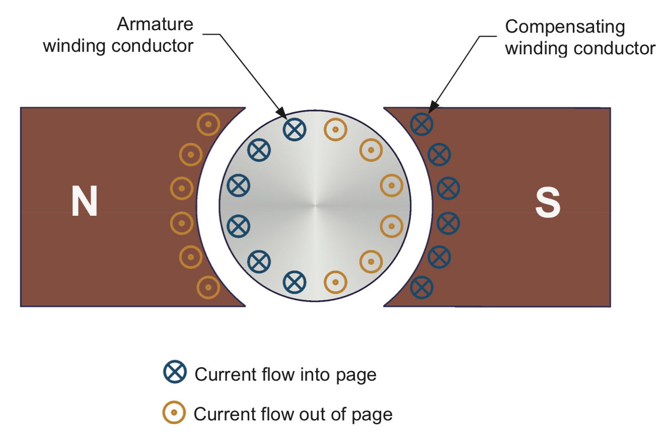

For proper operation with AC supply, a universal motor incorporates a compensation winding, in series with the armature and field winding.
Image credit: circuitglobe.com
When the motor runs on AC voltage, the alternating flux causes a reactance voltage, which limits the current to a much lower level than would be produced with DC voltage. To limit the effects of this armature reaction, the universal motor uses a compensation winding, which is installed in the slots of the stator, 90 degrees electrical from the main field winding and connected in series with the armature and field winding. (This arrangement is referred to as “conductively compensated.”) The current flowing in each coil of the compensating winding is in a direction opposite to the current in the corresponding armature loop near it. The winding of equal coils in opposite directions produces a cancelling effect that reduces inductance, and therefore, reactance.

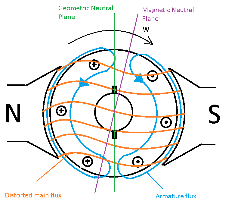

Armature reaction is the interference of the main field flux caused by the armature flux. This distortion and weakening of the main field flux changes the location of the magnetic neutral plane, which is the axis along which the brushes should be placed.
universal motor
Armature reaction changes the location of the magnetic neutral plane, which is the axis along which the brushes should be mounted.

To reduce inductance in the armature, the current flowing in each coil of the compensating winding is in a direction opposite to the current in the corresponding armature loop near it.
