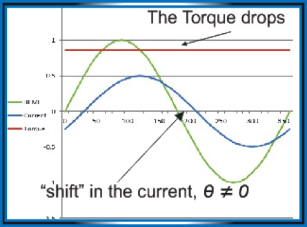

10-vector-control-loop-sinusoidal-currentWhen Cos θ ≠ 1, the results are torque degradation, torque disturbances, and excessive heat.
11-shift-in-current-drives
A high-performance vector control scheme that fulfills Cos θ = 1 at any condition, with the right back EMF commutation, results in the highest torque that is smooth and stable.
12-torque-disturbance-current-shift
Operating at this point also eliminates the need to force more current through the motor and consume more power to get the required torque.
Any operation at Cos θ ≠ 1 wastes energy and creates excessive heat.

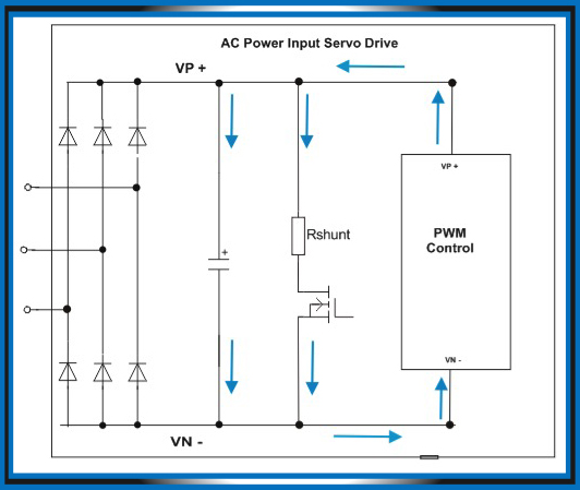

Servo drive — regenerating AC power input
18-regenerating-ac-power-input-servo-drive
During regeneration (braking), the power flows from the power stage back to the DC bus in AC power input servo drives.
Power in the reverse direction charges the bus capacitance up to a certain trip voltage. Then a shunt turns on and dissipates the reverse energy flow. No energy flows from the mains.

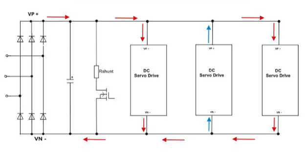

In a DC shared bus, all drives connect to the same DC bus. The regenerating reverse power is used for motoring the other axis.
20-shared-dc-power-Elmo-drive
The benefits are:
1. No need to dissipate the reverse power internally.
2. No heat to expel from the drive, thus no need for additional cooling in the form of heat sinks, fans, etc. Note: The heat dissipated by a typical shunt operation is usually much higher than the heat dissipated by a PWM bridge.
3. Less power consumed from the mains
4. Less AC power gets rectified into DC voltage. AC rectification is a significant source of heat and reduces efficiency dramatically.
5. The energy saving in a multi-axis machine can exceed 5%. In extreme cases such as tension control (winding- unwinding machines) the saving can reach exceed 80%.

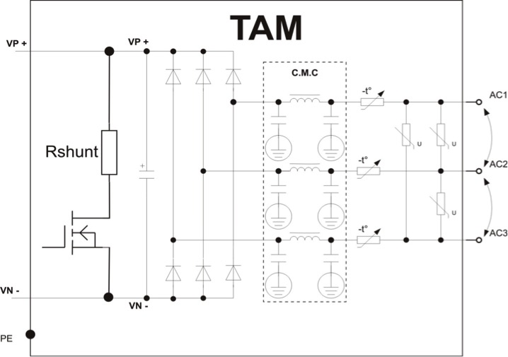

Note that Elmo’s Tambourine (TAM) is a compact shared DC bus power supply designed to power multiple servo drives.
What is a power supply for servo drives?
The nature of servo operation requires specific qualities from the power source. In most cases, the source is an AC line, single or three phases, wired either directly to the mains or via an isolation transformer. Servo operation requires a voltage source that is reliable, simple, capable of delivering momentary high power demands, and which conducts power from and to the motor (in four quadrants of operation).
In addition, the power supply must withstand a hostile operating environment: Voltage instabilities, high spikes, transients, bursts, EMI, high mechanical vibrations and mechanical shocks, extreme temperature, high humidity, and so on.
The Elmo TAM meets these specific tough requirements, and has two major tasks: Supply the DC bus voltage needed to power the servo drives and absorb the regeneration or braking power from the motor and mechanical load
To do this, the TAM:
• Rectifies the AC voltage input into a DC bus voltage; acts as a bi-directional energy reservoir for the servo system’s continuous and instant peak power demands.
• Acts as a shunt regulator for absorbing energy from the load during regeneration or braking; acts as an inrush-current limiter
• Acts as a high-frequency current ripple or swallower; filters EMI from and to the servo drives
• Provides line-voltage transient protection; and provides a measure of safety
Simplified schematic of a power supply for servo drives
21-schematic-power-supply-for-servo-drives
