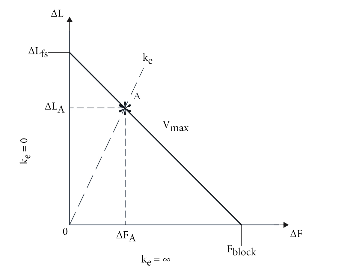

Piezo actuators operate on the inverse piezoelectric effect: when voltage is applied, the actuator contracts or expands. But when the actuator is blocked from moving (by a load applied in the direction of travel), it generates a force. This relationship between displacement and force in piezo materials is an inverse relationship. In other words, the more force an actuator must generate against a load, the less travel it can produce. A “free” actuator — one that experiences no resistance to movement — will produce its maximum displacement, often referred to as “free stroke,” and generate zero force.
Conversely, when an actuator is blocked from moving, it will produce its maximum force, which is referred to as the blocked, or blocking, force. Theoretically, when the actuator is blocked, it is working against a load with infinitely high stiffness. But materials with infinite stiffness don’t occur in the real world, so the blocking force is determined by applying a voltage to the actuator, with no load applied. This “free” operation, as described above, generates the actuator’s maximum displacement, or free stroke. A force is then applied to return the actuator to its original length. This force is measured and recorded as the blocking force.
The stiffness of the actuator is the ratio of blocking force to free stroke.
piezo output force
kp = stiffness of piezo actuator
Fblock = blocking force
ΔLfs = free stroke (nominal displacement) with no external load
piezo output force
In piezo actuators, force and displacement are inversely related. Maximum, or blocked, force (Fblock) occurs when there is no displacement. Likewise, at maximum displacement, or free stroke, (ΔLfs) no force is generated. When an external load is applied (A), the stiffness of the load (ke) determines the displacement (ΔLA) and force (ΔFA) that can be produced.

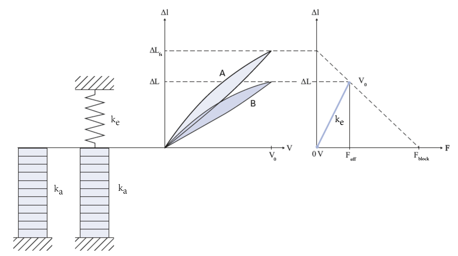

Piezo output force and displacement with a non-constant (spring) load
Many piezo applications, such as valve operation, introduce loads that vary with the piezo’s stroke — in other words, spring loads. When the stiffness of the applied spring load is low compared to the piezo stiffness, the piezo output force (Feff) is small. In other words, a spring (load) with low stiffness provides very little “blocking” for the piezo to work against in order to generate a force. Therefore, the piezo output force is greatly reduced from its maximum, or blocking, force.
piezo output force
Feff = force produced with spring load
ke = stiffness of applied load
On the other hand, the spring reduces the actuator’s displacement only slightly:
piezo output force
ΔL = displacement 0f actuator with spring load
piezo output force
Performance of a piezo actuator with no load (A) versus an actuator with a low-stiffness spring load (B). Note that the displacement (ΔL) with the spring load is slightly less than the maximum displacement, or free stroke, (ΔLfs), but the force produced (Feff) is much less than the maximum, or blocked, force (Fblock). The stiffness of the spring load (ke) is shown by the blue line.
Image credit: PI Ceramic GmbH
A low-stiffness spring load — typically no more than 10 percent of the piezo stiffness — is generally recommended for preloading a piezo actuator to ensure the displacement is not severely reduced.
