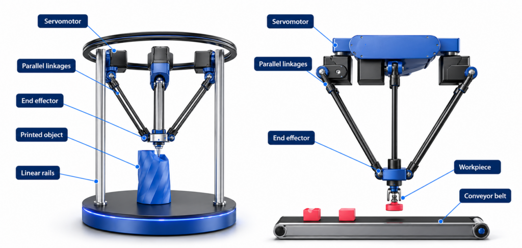

Integrated servomotors from EZmotion are especially suitable on delta-robot axes. EZmotion diagram enhanced with AI
In industrial automation, integrated servomotors like those in the demonstration detailed here impart motion to optical alignment stages, pick-and-place heads, and micro-assembly manipulators. Some delta pick-and-place machines and consumer-grade delta 3D printers also use servo-driven parallel kinematic structures.
