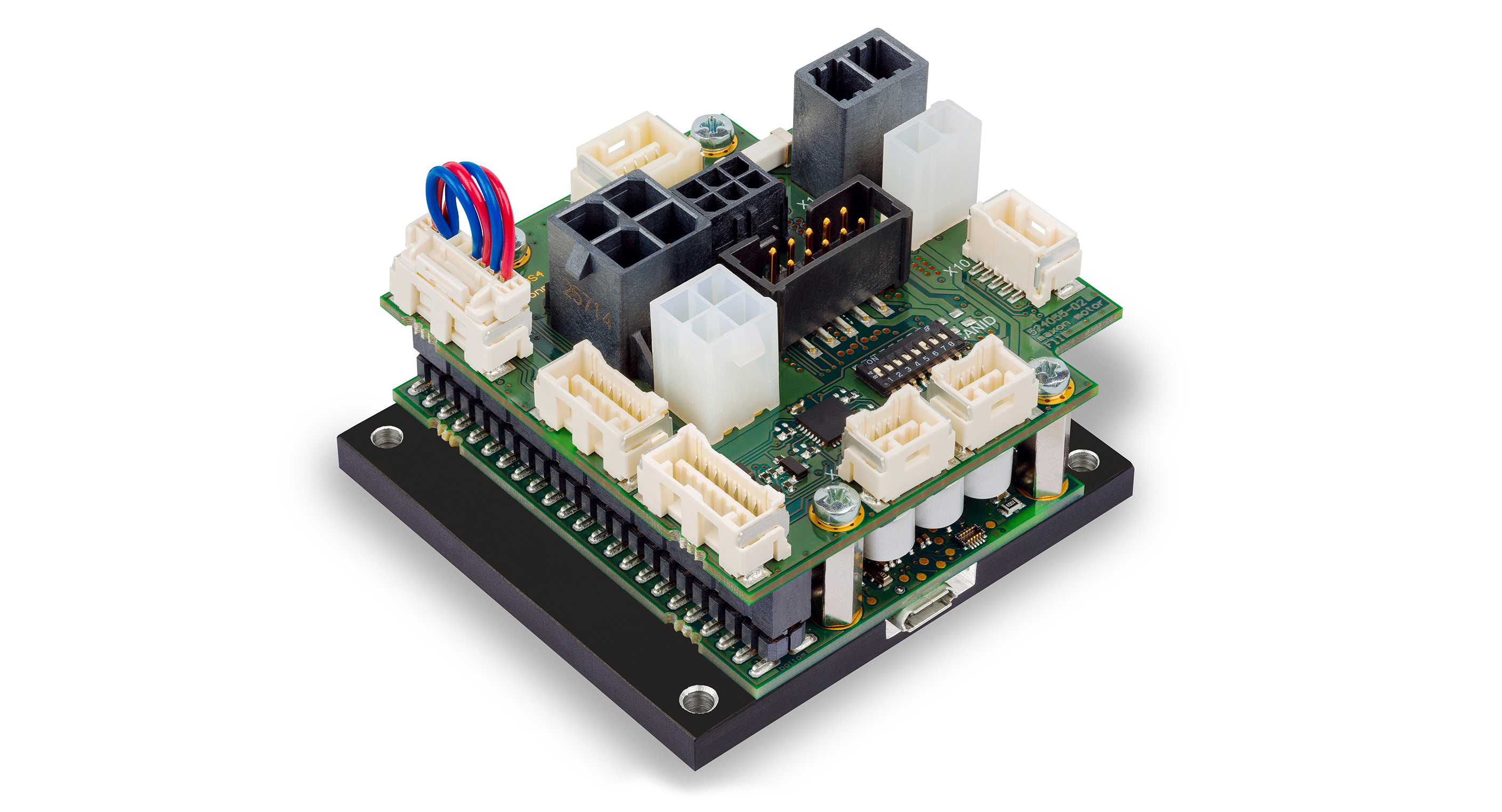

maxon motor has now expanded its line of EPOS modular digital-positioning controllers. These drive+controllers are suitable for controlling permanent-magnet motors (including encoders) with 1 to 1,050 W of continuous output power. The wide range of operating modes (as well as various command interfaces) make it work in different drive systems employed in automation technology and mechatronics.
The EPOS4 Compact 50/8 EtherCAT and EPOS4 Compact 50/15 EtherCAT units from maxon are compact devices from this line that are also compatible with the industrial Ethernet option known as EtherCAT.
Click to enlarge.
The fully integrated plug-and-play positioning controller in a compact design suitable for networks with cycle times to 1 msec.
Powerhouse with performance position-control characteristics
The functionality, operation, software, and accessories of the new controllers are derived directly from existing products in the EPOS4 range.
The devices are suitable for use with both brushed DC and brushless EC motors (BLDC) and come with comprehensive feedback options such as Hall sensors as well as incremental and SSI absolute encoders. State-of-the art concepts such as FOC, feed forward, and observer control allow optimal control in a wide variety of applications.
