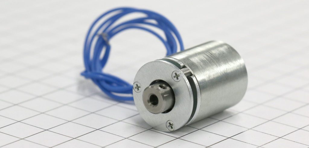

Some electromagnetic spring-applied holding brakes from Ogura have diameters down to 10 mm.

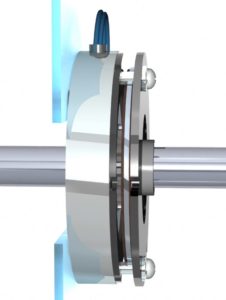

Above: When power is applied, magnetic flux is created. That in turn pulls the pressure plate toward the coil body — compressing the springs and freeing the friction disc to allow rotation. Airgaps are a critical feature of an electromagnetic spring-applied brake. The airgap shown in the cutaway is with the brake engaged and no power being applied.
How is this functionality built into a customized brake? Well, it’s done through optimization of magnetic flux during the design stage. Recall from basic physics that magnetic flux naturally follows the path of least resistance. Within an electromagnetic brake, it takes stronger flux to jump the airgap when engaged. Also, the springs in spring-applied brakes need to compress as the pressure plate crosses the airgap. Once compressed, the pressure plate contacts the field coil … and the holding power is strong with power applied.
