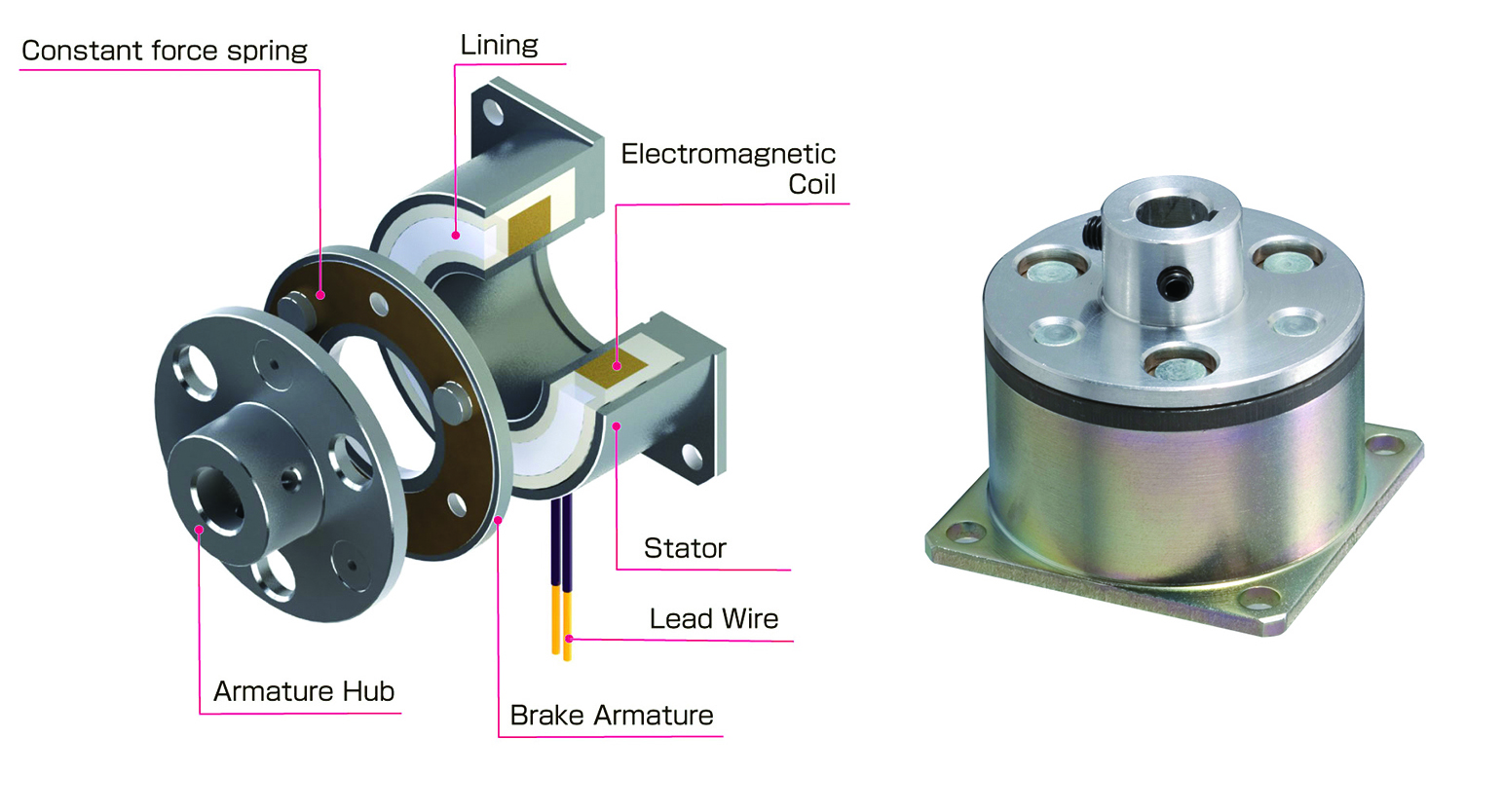

Electromagnetic Micro Brakes from Miki Pulley are a compact, high performance braking solution for small, precise motion control applications.
Model 112 Micro Brakes from Miki Pulley ouput fast braking response when the rotating portion of the brake (armature) engages the stator when the coil is energized. A constant-force plate spring transfers torque to the rotating brake body halting all motion. These brakes are suitable for precise motion applications.
Miki Pulley’s ultra-compact brake design ensures fast response in high torque demanding applications. The simple yet effective design features a stator with integrated mounting flange, proprietary composite friction liner and armature complete with ring plate spring and hub.
These field-proven Miki Pulley Micro Brakes halt rotation mechanically by using electromagnetic field to create mechanical friction. With fast response, the brake’s armature engages the stator when the coil is energized. A constant-force plate spring transfers torque to the rotating brake body halting all motion.
Additional features include quiet operation, high holding torque for its size, space saving design configuration, long service life, stable and reliable braking power. Easily installed, these Miki Pulley Micro Brakes need no maintenance and come in three armature-assembly options to satisfy myriad application requirements.
112 Model Micro Brake specification range based on model selected:
Brake torque: 0.295 ft-lb to 1.770 ft-lb (0.4 Nm to 2.4 Nm)
Backlash: Zero
Ambient temperature: 14° F to about 104° F (-10° to about 40° C)
