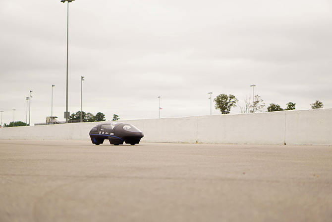

One little hydrogen fuel-cell vehicle holds the Guinness world record for the most efficient vehicle … and uses a slotless brushless 60L-H-175-A from Koford Motors to drive its rear power wheel. This year, the tiny car from the Duke Electric Vehicles team beat the 12,600-mpg efficiency of the PAC CAR 2, in turn designed by a student team at the Eidgenössische Technische Hochschule (ETH) in Zürich, Switzerland.
According to Patrick Grady (president of the Duke Electric Vehicles team until he graduated this year) their fuel-cell vehicle Maxwell (in its final World Record iteration) has a 15-mph design speed and 40.8 W of total power (sourced from hydrogen chemical energy). During redesign based of a Maxwell predecessor, the team saw that with a nominal fuel-cell efficiency of 58% average electrical energy from the fuel cell (used by the motor) couldn’t exceed 23.6 W. With a motor and drivetrain efficiency of 87% or so, mechanical power dissipation couldn’t exceed 20.6 W.
