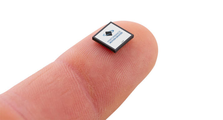

Performance Motion Devices now sells new Juno Step Motor Control Integrated Circuits (ICs) in a 56-pin VQFN package. The new Juno Step Motor Control IC is the latest addition to the Juno Velocity and Torque Control IC family … the industry’s first family of compact ICs with full four-quadrant motion control; direct input accepted from quadrature encoders; profile generation; and advanced current control.
Juno ICs are for designs with limited space that need to control noise, vibration, and power consumption. Juno ICs are also easy to deploy with embedded motion commands and onboard intelligence.
Performance Medical Devices recently released the Juno Velocity and Torque Control IC series — the industry’s first family of compact ICs with full four-quadrant motion control, direct input quadrature encoder, profile generation, and advanced current control.
The Juno Step Motor Control IC 56-pin VQFN package has the highest PWM frequencies offered by Performance Motion Devices and the smallest IC parts — measuring 7.2 x 7.2 mm. Juno Step Motor Control ICs are available both with encoder input and without.
The Juno Step Motor Control IC also comes with numerous safety features … including stall detection, over- and under-voltage sense, overcurrent detection, over-temperature, and i2t current foldback. Coupled with compact MOSFETs, the Juno Step Motor Control IC can replace older step motor amplifiers and dramatically reduce the size and heat output.
