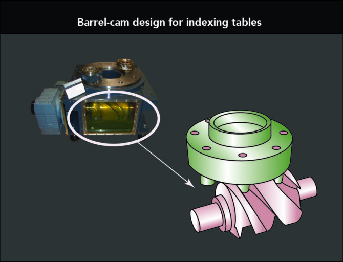

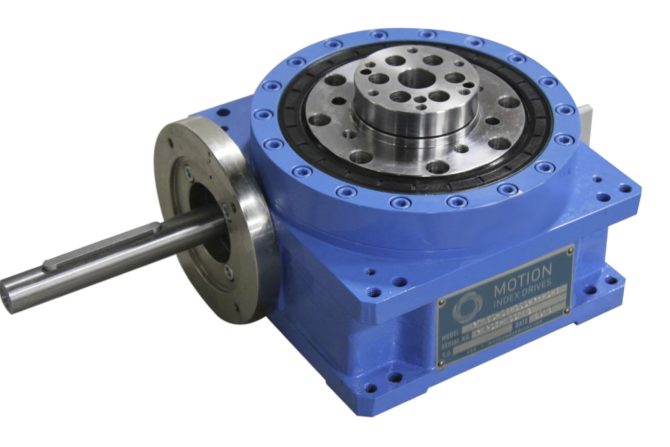

Cam-based setups that run at constant speed convert constant input-drive motion (from a motor) into intermittent motion output through mechanical means. Indexer-part manufacturers digitally shape the cam upfront so it doesn’t cause jerk but instead makes soft and shockproof strokes optimized for the task at hand. Most such cams go into assemblies to maintain secure mounting to the output table (sometimes called a dial). The motor is usually a three-phase brake motor that transmits power through a chain wheel, belt wheel, or gear reducer to the table driveshaft. This connects directly to the barrel cam to turn cam followers and output flange. The flange sits inside a wire-bearing assembly free of backlash, and the whole drive is sealed against ingress.
Some versions include flame-hardened cams and followers for smooth acceleration and deceleration as well as robust endurance in extreme environments. Accuracies to ±0.008 mm are standard with myriad configurations. One option is a locking dwell to get standalone precision for critical stations. Other choices include a reinforced output-flange bearing for higher tilting moment; an optional friction clutch on the drive; and dwell and step angle tailored to specific requirements.

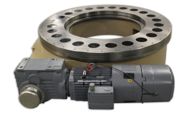

As mentioned, flexible indexer designs use either a servomotor setup or an ac-motor setup with an encoder. Indexing tables that run off a VFD can cycle the motor driving the cam at a preset speed to a preset dwell and then stop. That lets the dial park at a location for seconds to hours — to allow processes at a station to complete before advancing a workpiece to the next station, for example. The encoder tracks camshaft position for high positioning accuracy. Some designs have the output dial ride a high-precision four-point bearing assembly preloaded against runout. Some manufacturers seal the whole drive against dust and moisture ingress.
The drawbacks of the other flexible indexer setup — that based on programmable servos — have already been mentioned. But to address a major issue for applications that need the highest level of programmability, some manufacturers design their servo-based programmable index tables so they’re identifiable by all robot brands and controls.
Note that cams provide mechanical benefits even in these forms that rely on controls for some motion profiling. Consider how these indexer setups have a gear reducer that connects the motor to the barrel cam’s input shaft, but the barrel cam rotates the top dial through cam followers with a rigid zero-backlash connection. This direct connection between the table’s rotating dial and cam eliminates the focus during design sizing on toque output for geared linkages. Instead, the machine builder can work with the manufacturer to size the cam drive to the total system and payload moment of inertia. That ensures the kinematic assembly of the indexing table withstands the application’s inertia loads without issue.
