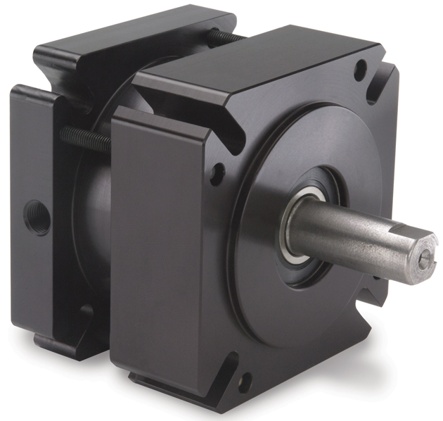

Nexen Group’s Eclipse Servomotor Brakes offer distinct advantages over spring-engaged, electrically-released brakes. With Nexen’s servo motor brake, no energy is consumed when the brake is disengaged. (Electrically-released brakes consume power continuously, even in disengaged mode, creating heat inside the brake, which detracts from its ability to produce full torque.) It is spring-engaged/air-released (no electric coil) to keep the brake cool until it’s needed. More after the jump.
Nexen-ServoMotor-Brakes-new-offering
Nexen’s servo motor brakes are designed to mount to the shaft end of servo motors up to 20 horsepower, including NEMA 23, 34 and 42 frame sizes. The brake’s square-shaped housing allows flexibility to custom make the mounting features match the motor dimensions. The brake’s output end duplicates the motor mounting features. The input end bore accepts the motor shaft and is fixed inside the brake with a split-hub/shaft collar arrangement.
