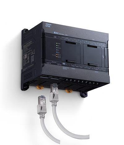

Omron Automation Americas recently announced the release of its new CP2E Series all-in-one controller that provides advanced control that enables IIoT connectivity for compact machines. The controller improves manufacturing productivity and quality by making it easy to visualize the performance and data of connected machines through simple programming.

  • Improved connectivity for Ethernet and serial devices. The CP2E has two Ethernet ports with Ethernet switching function: host and HMI connectivity. Up to three serial ports are available for open connectivity to serial devices.
  • Reduced effort for the setup of complex machines. Function blocks make it easy to achieve 4-axis positioning function with linear interpolation, and the CP2E also provides a PID control with autotuning function block for stable temperature control.
  • Simplified troubleshooting. The CP2E’s input/output terminal LED indicators ensure quick and easy root cause identification, while the controller’s ability to automatically detect and recover from bit corruption increase machine efficiency and avoids CPU stops.
  • Increased peace of mind. The CP2E is a reliable “install and forget” solution for demanding environmental conditions, as its extended operational temperature increases reliability in special applications and its battery-free operation reduces maintenance costs.
