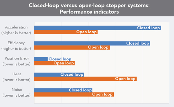

Open-loop vs. Closed-loop efficiency
To measure the relative efficiency of an open-loop vs. closed-loop system, assume we repeat the same test with the same two motors of equal size. This time we have the closed-loop and open-loop motors run side by side with the same inertial loads but run programming that holds the move profiles constant and equal, so that both systems perform the same amount of work.
This is a Relative Comparison Chart for StepSERVO closed-loop systems versus open-loop systems. Note the superior performance of the closed-loop stepper system as demonstrated in the results of laboratory testing that compare two systems for acceleration (torque), efficiency (power consumption), position error (accuracy), heat generation, and noise levels.
While the two motors index the same move profile repeatedly, current draw from the dc power supply feeding the two systems is measured and power consumption is calculated. As can be seen in value plots, average power consumption of the open-loop stepper system is 43.8 watts, while that of the closed-loop system is only one third as much — 14.2 watts on average. This dramatic difference in power consumption clearly shows the higher efficiency operation of the closed-loop system. Any user looking to increase the system efficiency of their open-loop stepper system can now consider a simple upgrade to a closed-loop system and expect significantly lower consumption.

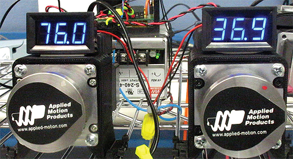

How to address motor heating
A natural extension of the power consumption tests is the investigation of motor heating. Open-loop stepper systems are simple beasts. One simply sets the drive for the motor’s rated current and the drive will do its best to supply that current to the motor at all times, whether the resulting torque is needed or not. This often causes the generation of heat instead of energy towards the application function — and is the reason why open-loop stepper systems typically run hotter than closed-loop counterparts. It also means that machine designers must take additional steps to deal with this heat, often by including special guarding around step motors that will run in the vicinity of human operators, or by installing additional cooling systems such as fans.
Consider the results of a motor heating test conducted in a laboratory using the same open-loop and closed-loop systems as above. In this test, the two systems again produce the same amount of work driving the same inertial loads, and are allowed to operate until they reach thermal equilibrium. The open-loop system reaches a case temperature of 76.0° C, whereas the closed-loop system reaches thermal equilibrium at a case temperate of only 36.9° C — less than half that of the open-loop system. This significant reduction in motor heating can mean lower component costs for machine builders, because they can omit extra guarding and cooling subsystems.
This is a laboratory test temperature comparison of a StepSERVO closed-loop system and an open-loop system. It shows the results of a motor heating test using the same open-loop and closed-loop
systems as in the other tests detailed in this article.
