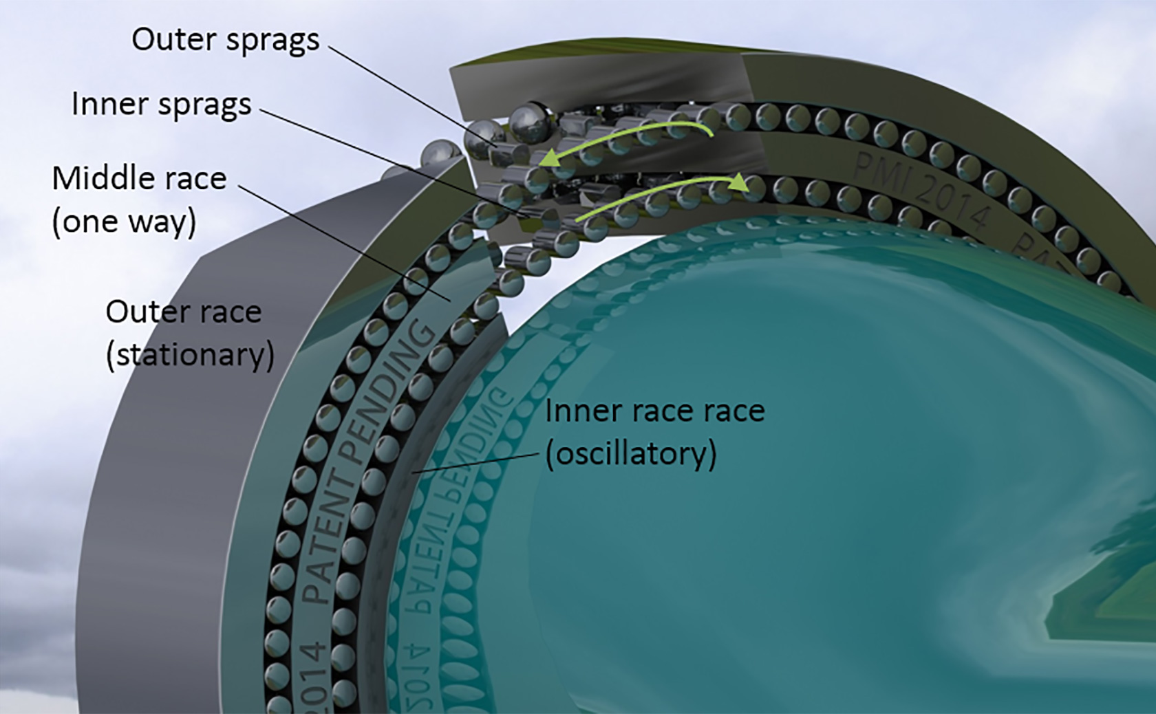

Plymouth Machine Integration has made a provisional patent application for a design that uses two concentric one-way bearings, installed such that their actions are opposed. With a modest amount of oscillatory motion, it induces large movements of the intermediate race — and both sets of rollers. That evenly distributes the lubricant.
How does it work? The motion in the intermediate race is from a one-way clutch in one of the two bearings holding that race motionless with respect to first the inner, then the outer race, depending on the direction of rotation within the period.
In this way, the design avoids false brinelling by maintaining a lubricant film and preventing adhesion of surface asperities.
2-solution-to-bearing-brinelling
This setup from Plymouth Machine Integration includes two concentric bearing rings fitted with one-way sprag clutches oriented in opposite directions. Small relative oscillatory motions of the inner race alternately lock and unlock the two clutches, in opposite phase. The middle (common) race is advanced in a single direction, by an angle equal to the amplitude of the oscillatory motion. The average motion within each bearing is non-zero, promoting movement of the lubricant within the rolling elements.
One caveat: This design doesn’t resolve issues from assemblies that lie motionless for substantial periods of time between uses — on spare electric motors, for example. This needs oscillatory motion of a magnitude large enough to engage the one-way clutch … oscillatory motion that’s either natural to the operation of the machine or imposed on the controls.
