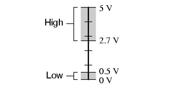

The “high” and “low” states of a digital signal refer to the signal’s voltage and whether it is able to turn on circuits. In general, a “low” level, which is typically the same as ground (0 to 0.5 V), means the signal is not at a voltage sufficient to activate a circuit. Alternatively, a signal “high “ level, typically 2.7 to 5 V, is sufficient to turn on a circuit.
Image credit: Tony R. Kuphaldt, ibiblio.org

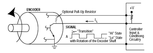

The simplest type of output driver is the open collector, or NPN (sinking) output. An open collector driver sinks current from PNP (sourcing) inputs—either the PLC or motion controller. In the on state, it supplies a path to ground, and in the off state, it floats – that is, it is neither high nor low. So there must be a way to manipulate its voltage in order to indicate a logic high signal. This is where a pull-up resistor comes in.
pull-up resistor
Typical open collector encoder output
Image credit: Dynapar Corp.

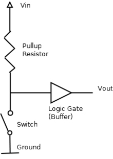

pull-up resistorThe basic function of a pull-up resistor is to ensure that when there is no input, a circuit takes on a default value. In other words, it sources current from the power supply to pull the voltage up to a specified value (typically the operating voltage) so that it can be read as a logic high signal. The output causes the voltage to drop to its low, or ground, state (0 V). This switching of the output pulses on and off creates a square wave.
