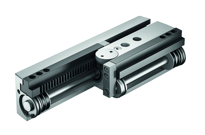

This gripper setup from Festo uses a rack-and-pinion linkage.

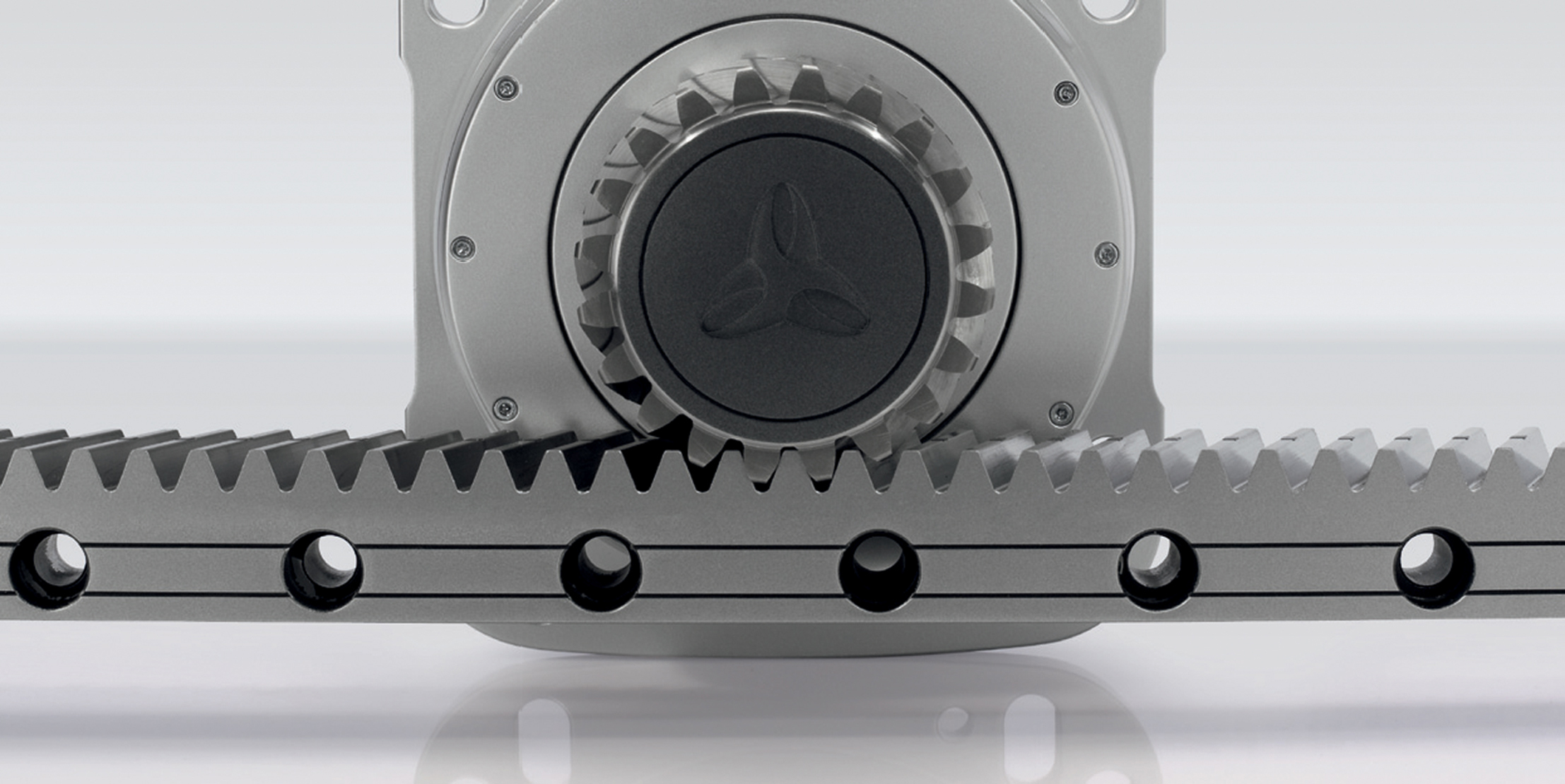

3-Wittenstein-case-hardened-rack
This dynamic rack-and-pinion system from Wittenstein can drive linear motion to unlimited travel lengths. Some preassembled versions run true to 10 µm; those with actuators and servogears exhibit less backlash than standard setups.
