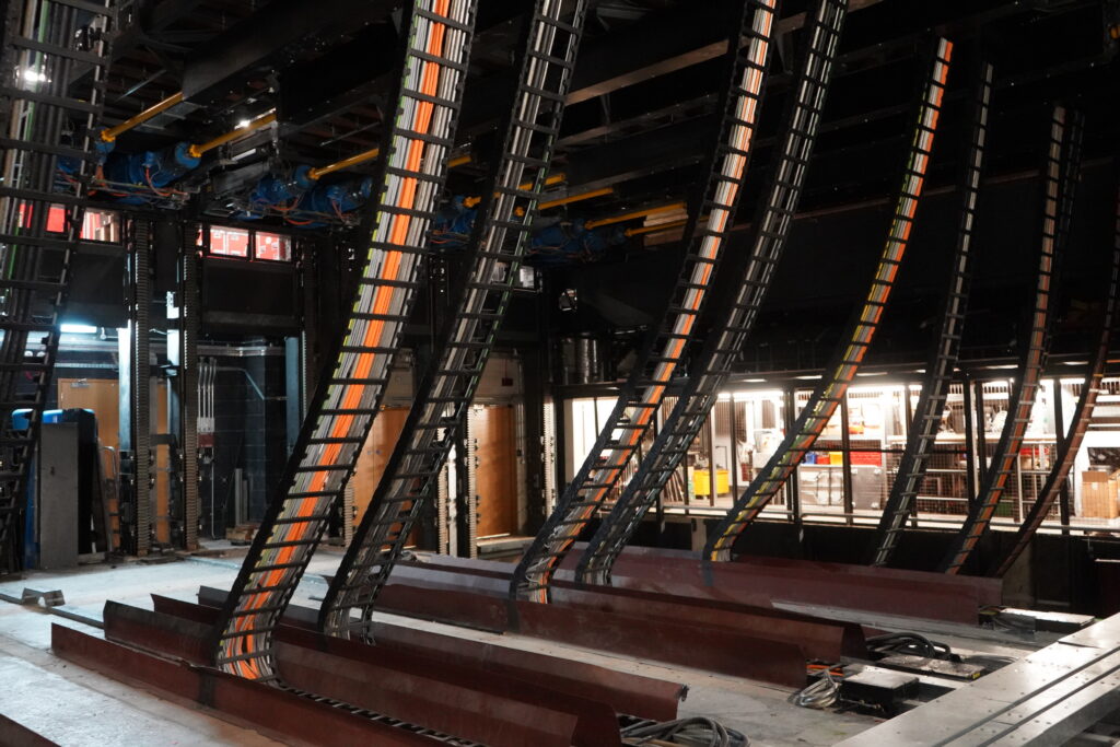

The igus energy chains include robust chainflex motor, bus, data, fiber optic and control cables that can reliably withstand continuous movements over many years.

To counteract the pendulum effect, engineers arranged the zigzag system in a reverse pattern, installing two e-chains per unit that move in opposition to cancel the lateral forces out.
Zigzag systems work by folding the energy chain neatly into a basket. As the platform rises, the chain unfolds smoothly and quietly, delivering a space-saving solution for dynamic platforms without placing tensile strain on the cables. These systems also make adding or replacing individual cables a fast and easy process.

Zigzag systems, which fold and unfold vertically, naturally generate a slight pendulum effect due to their geometry. At the ROH, the massive cable load amplified this effect, with initial tests revealing 1-meter lateral deflections during operation. In a stage environment where trusses are close each other, such wide sway is a safety hazard. So, to counteract this effect, engineers arranged the zigzag in an opposed pattern. By installing two e-chain energy chains per unit that move in opposition, the lateral forces cancel each other out. Using high-precision laser measurements, engineers confirmed this configuration reduced lateral sway from 1 meter to just 20 millimeters.
The igus cable management system spans more than 25 meters and consists of nine tons of energy chain.
For the center truss units, the engineers also implemented two guide boxes with one chain each. On the shorter side units, where space was tighter, they designed two chains to fold compactly into a single box.

In addition to the zigzag system, the igus cable management solution included its E4.56 series e-chain, specifically designed for high loads and long travel, all while maintaining a low-noise profile. Inside these chains, igus installed a suite of chainflex cables, which unlike standard cables, are engineered for continuous motion. These cables also feature electromagnetic compatibility to prevent interference with other stage equipment, as well as an ability to withstand vertical travel and the folding stresses of the zigzag system over millions of cycles.
The installation includes more than 1 kilometer of igus chains weighing 9 tons and a total vertical travel of more than 25 meters. Operational speeds reach 250 millimeters per second.
