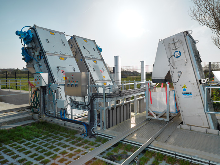

3-Festo-pneumatic-application-example-filters
This application is a pneumatically operated penstock driven by linear actuators from Festo. It runs at a pumping station on the British island of Guernsey to direct rainwater into storage basins for treatment (to make drinking water) or pumping out to sea (to prevent flooding). Centralized controls automate the whole process.
