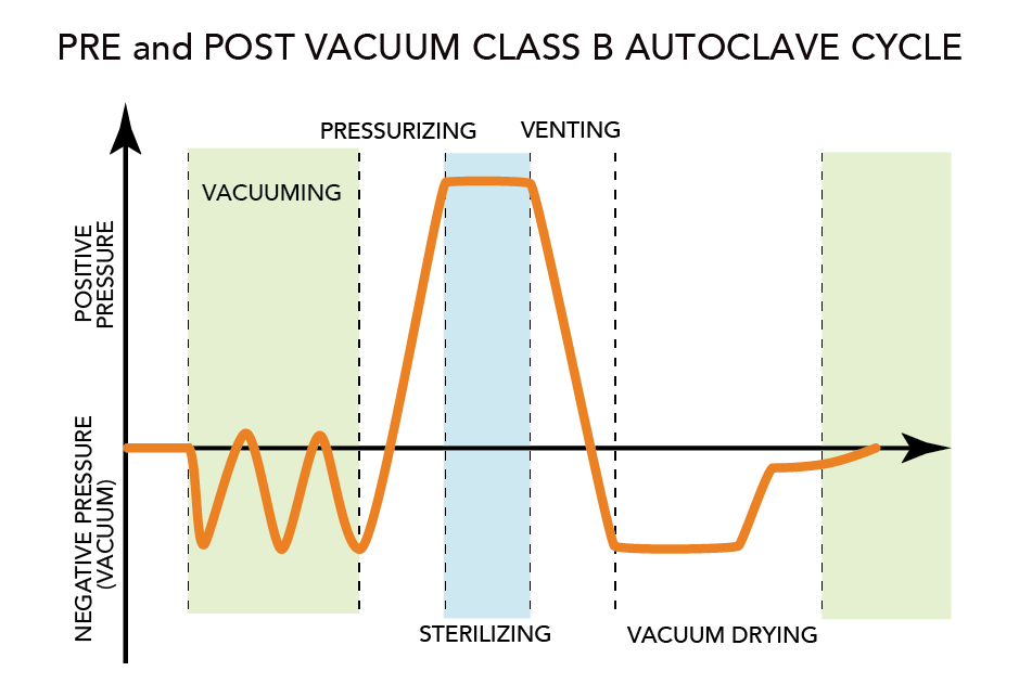

What is an autoclave cycle?
The most common sterilization method used in hospitals is autoclaving, also called steam sterilization. During autoclaving, surgical handtools are exposed to 100% humidity, 135ºC (275ºF) and pressure variations for up to 18 minutes. Most autoclaves also have additional vacuum cycles to facilitate steam penetration and kill viruses, fungi, bacteria, and spores that can hide in microscopic cavities on the device. Repeated exposure to this environment is what typically causes significant electrical and corrosion problems for motors and devices insufficiently designed to withstand these conditions.

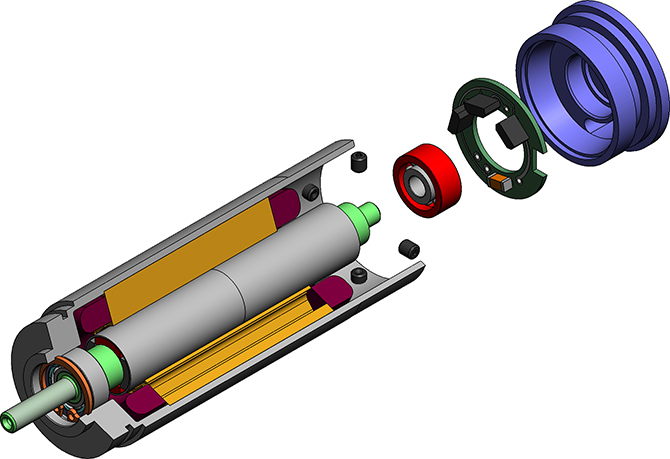

Slotless motors are the other BLDC motor technology. These motors are also very capable and may be well suited to the application. In slotless motors, the coil is wound in a separate external operation and is a self-supporting subcomponent.
This is a brushless dc slotless motor.
This rigid coil is then inserted directly into the air gap during motor assembly. In this design, the magnetic induction in the coil is decreased since the air gap is large. Induction in such a motor is usually much smaller than in a slotted BLDC motor, so a larger and more powerful magnet is typically needed to compensate for the loss of induction.
While slotless motors can be designed to withstand steam sterilization through insulation and other protective coatings on the exposed electronic components, achieving long-lasting and dependable protection from harsh environmental conditions is inherently more challenging when compared to a slotted motor. If autoclavability or very high numbers of sterilization cycles are not needed — there are aspects to a slotless design that may be an advantage for a given application: zero detent torque (no cogging), smooth operation at very high speeds, increased motor inertia, and high peak torque capability.

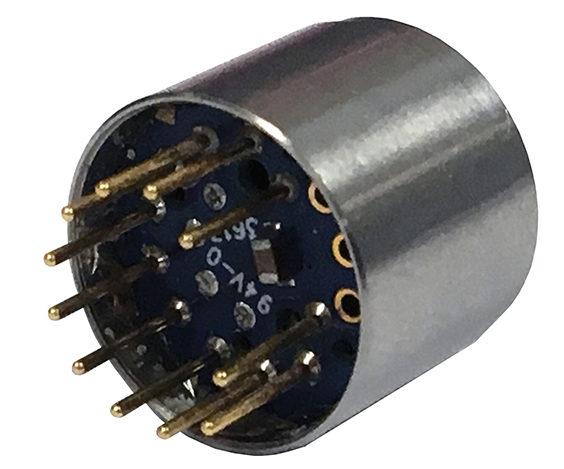

In autoclavable applications such as surgical tools, magnetic encoders are typically a robust and reliable option. Incremental or absolute feedback are two common variations for communicating the angle value. If using incremental signals an index pulse, once per revolution, and a counter is needed to calculate the absolute angular position. Otherwise the feedback is relative.
This is an autoclavable encoder.
Absolute feedback is typically serial communication such as SSI, SPI, or BiSS to provide an encoded angle value between 0° and 360°. Options from Portescap include:
• Sterilizable option — designed and tested to more than 2,000 autoclave cycles
• Hall sensor signals for 6-Step commutation (U, V, W)
• 10-Bit incremental encoder (A, B, Z)
• 11-Bit resolution absolute angle encoder
• Absolute position output via SPI
• Differential output for noisy environments
• Off-axis mounting allowing for cannulation
