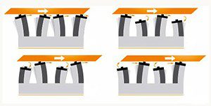

Another piezo technology that can produce rotary motion is the walking type piezo motor. These designs use multiple piezo bending actuators (or a combination of clamping and shear actuators) to rotate a ring. The piezo actuators are synchronized in pairs – often referred to as “legs.” When voltage is applied, the first pair of legs extends, grips the ring, and moves it in the desired direction. At the same time, the second pair of legs retracts away from the ring and moves in the opposite direction. On the next activation, the first pair of legs retracts and moves backwards while the second pair extends to make contact with the ring and move it further along its direction of rotation. Although each “step” is just a few microns, operating at high frequency provides thousands of steps per second, for high rotational speeds.
piezo motors
In a piezo walking motor, pairs of “legs” work together to produce motion in a longitudinal rod. The same principle can be applied to a ring to produce rotary motion.
Image credit: MICROMO
