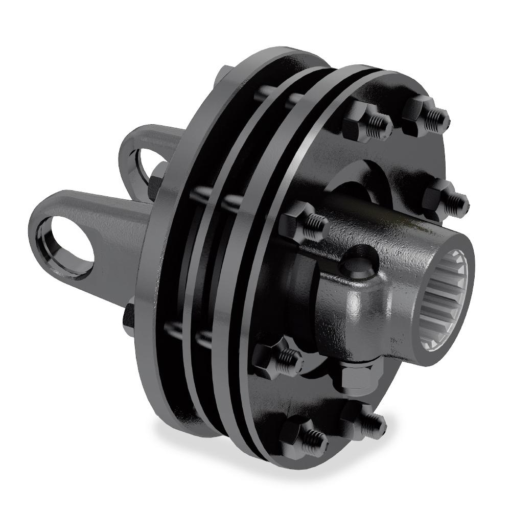

Friction torque limiters
Friction torque limiters slip in response to an overload event and fully engage other times. A spring-actuated frictional torque limiter applies spring force to opposing friction surfaces on input and output hubs. Exceeding a set torque level causes the surfaces to slip relative to one another, limiting power transmission. Pneumatic and hydraulic actuated torque limiters may also use friction material to transmit torque but rely on pistons or diaphragms moved by air or fluid pressure to force friction surfaces together and adjust torque limits.
Friction material may be dry or in an oil bath. Generally, higher-capacity units that dissipate more energy (or those designed to continuously slip) use oil cooling to maintain friction material at safe operating temperatures.
Though torque limiters differ from clutches in that they can’t or shouldn’t continuously throttle mechanical transmission, some temporarily slipping limiters (especially those based on friction plates) are referred to as slip or overload clutches. Friction-plate torque limiter image via Bondioli & Pavesi
These designs have a couple drawbacks. Friction-style torque limiters, dry or wet, wear over time and may need maintenance or eventual replacement. Debris generated by friction material in open, dry designs make them unsuitable for certain environments such as in clean rooms. Available sealed units contain the wear debris. In contrast, torque limiters employing permanent magnets that couple loads through magnetic flux have no friction material to wear or produce debris. Some electromagnetic types also work without friction material but need external power to generate magnetic flux.

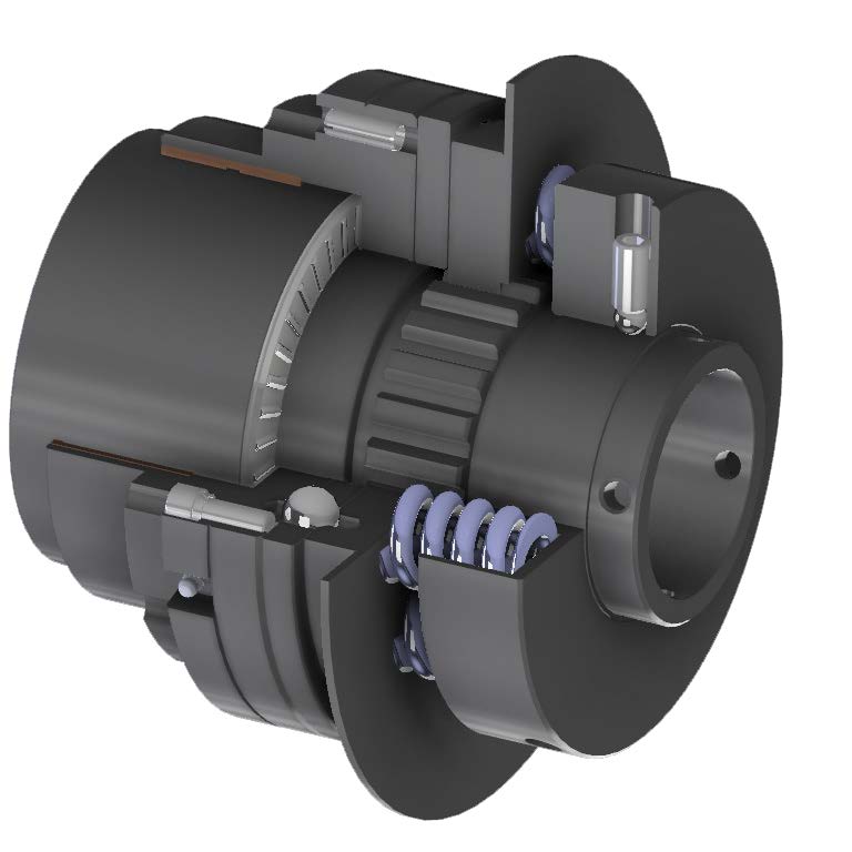

Ball-detent torque limiters
Ball-detent torque limiters may be automatic or manually resettable, while hybrid models combine both automatic and manual reset functions in a single unit.
Detent-style torque limiters transmit nominal torque then fully disengage when they see excessive torque levels, and freewheel until reset. A typical design uses springs to push bearing balls into pockets (detents) on a drive flange that transmits torque. Exceeding a set value overcomes spring force, which in turn dislodges the balls and uncouples the load. Depending on the configuration, an overload trip may need that an operator manually reset the device, while other designs automatically reset when the overload condition clears. Some units reset in multiple clock positions, while those used in timed mechanisms reset to the same clock position each time. Pneumatic or hydraulically actuated units often incorporate sensors that detect an overload condition and cut pressure to decouple the load.
Ball-detent torque limiter image via Carlson-Dimond & Wright • CDWdrives
