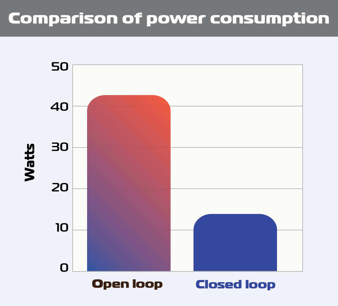

Test results confirm that closed-loop step motors draw current only when needed, so they run cooler and with less power consumption than open-loop options. Consider actual tests that run both the open-loop and closed loop variations to get the same motion profile:
  • Acceleration = 100 rev/sec2 and deceleration = 100 rev/sec2
  • Distance = 5 rev and speed = 10 rev/sec
  • Dwell time = 0.1 sec
Both carry a set load inertia and rotor inertia and operate from a 48-Vdc power supply. Results in the graph below show that the average power consumption of an open-loop stepper system delivering such output uses 43.8 W.
In contrast, a comparable closed-loop stepper system consumes only 14.2 W to deliver the same routine. That reduced power consumption translates into less heat generation and lower energy bills.
Results from tests conducted by Applied Motion Products confirm that closed-loop stepper systems consume less current than comparable open-loop stepper systems — and stay cooler too.
