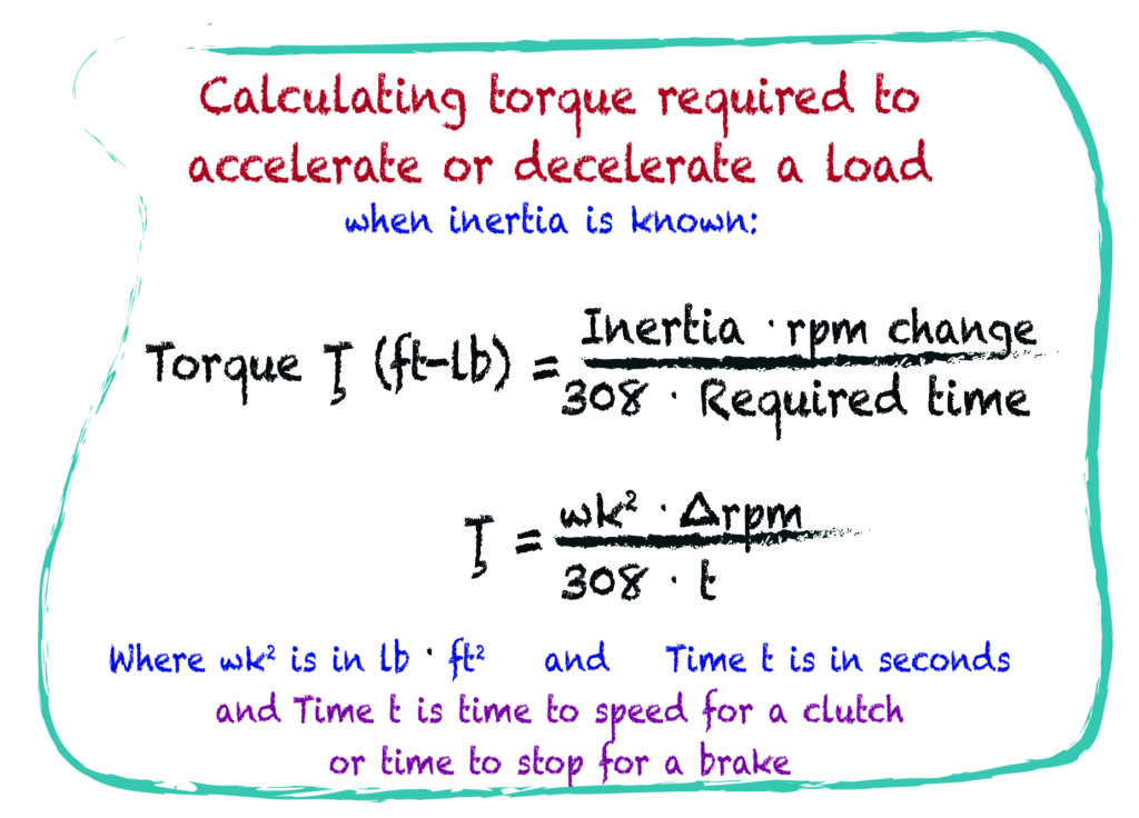

One: Power-off brake torque
When specifying a power-off brake, the first question to answer is: How much torque does the axis need? The two torque ratings for brakes are static torque and dynamic torque. On applications such as wheel drive brakes, the requirement is typically for holding only — a function that relates to static torque. Here, the motor brings the vehicle to a stop and then the brake engages. Therefore, static torque is the primary concern here.
For an electric vehicle or similar applications, engineers should also consider the maximum weight of the vehicle including payload (as well as the slope on which the vehicle may park). Torque required for holding on a slope will be much greater than holding torque needed on flat terrain. Sometimes there are regulations or industry standards dictating the required capabilities of a given holding brake as well.
On the other hand, select equipment needs brakes for stopping or e-stops. Take for instance the unwelcome scenario of interrupted power while an electric vehicle is moving at speed down a hill. Here, the brake needs a proper torque rating to stop the vehicle within a certain time or distance.
Here’s how to calculate required torque.
Keep in mind that for a particular brake, the ability to make dynamic stops (typically for emergency stops) is far more modest than the static torque rating might imply. This dynamic-stopping ability is highly dependent upon the engagement speed, heat dissipation capabilities, and the materials used in the brake’s working surfaces. With higher speed, the maximum energy-dissipation capabilities decrease. For applications involving the occasional dynamic stop, check with the brake manufacturer to discuss:
  • The application conditions
  • Allowable engagement energy for e-stops or
  • Total engagement energy allowed over the life of the product.
One of the best ways to reduce brake torque requirements is to mount the brake on the high-speed side of the axis’ power-transmission assembly. A common place to mount the brake is on the motor’s back end. (Some designs allow mounting on the front end but mounting on the back end is more common.) Mounting the brake on the “downstream” low-speed side — meaning after the gearbox or other speed reduction in the drivetrain — will proportionally increase the torque requirement … necessitating a brake that’s larger and more expensive. In contrast, keeping the brake “upstream” of the gearbox means that the payload and drivetrain inertia reflected back to that brake is reduced.

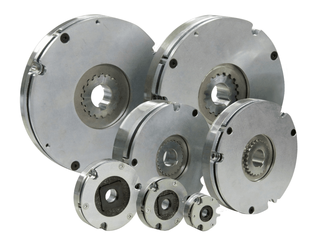

Four: Power-off brake size
There are a wide range of power-off brake sizes. The smallest are 10 mm in diameter or less and used primarily on micro motors. The largest electromagnetic spring-applied brakes on hoists or elevators are quite massive. The latest trend is for super thin brakes. The thinnest brakes are in the range of ½ in. or 12 mm. A great deal of this is a result of the robotics boom and the growth of the electric wheel drive market. For robotics, thin brakes on robotic joints allow for a smaller assembly, lower inertia, and greater throughput from the system. For wheel drives, two motors are often mounted inline and axial space is extremely limited. Often, super-thin brakes mount on pancake type drive motors. Specialized brake bodies can even serve as the end bell of the motor to save still more space.
Shown is an example of super thin brakes made by Ogura.
The relationship between size and torque is defined by the laws of physics. However, power controls have become more sophisticated and commercially practical over the years. Moreover, it’s possible to get more torque in a smaller package when compared to designs from years ago. Selected brakes now use overexcitation to overcome the spring force to disengage the brake. After a quick disengagement, inductance (magnetic strength) of the brake increases and the power required lessens while keeping the brake in that disengaged state. This also helps with heat and power consumption.
Shown are examples of micro brakes made by Ogura.

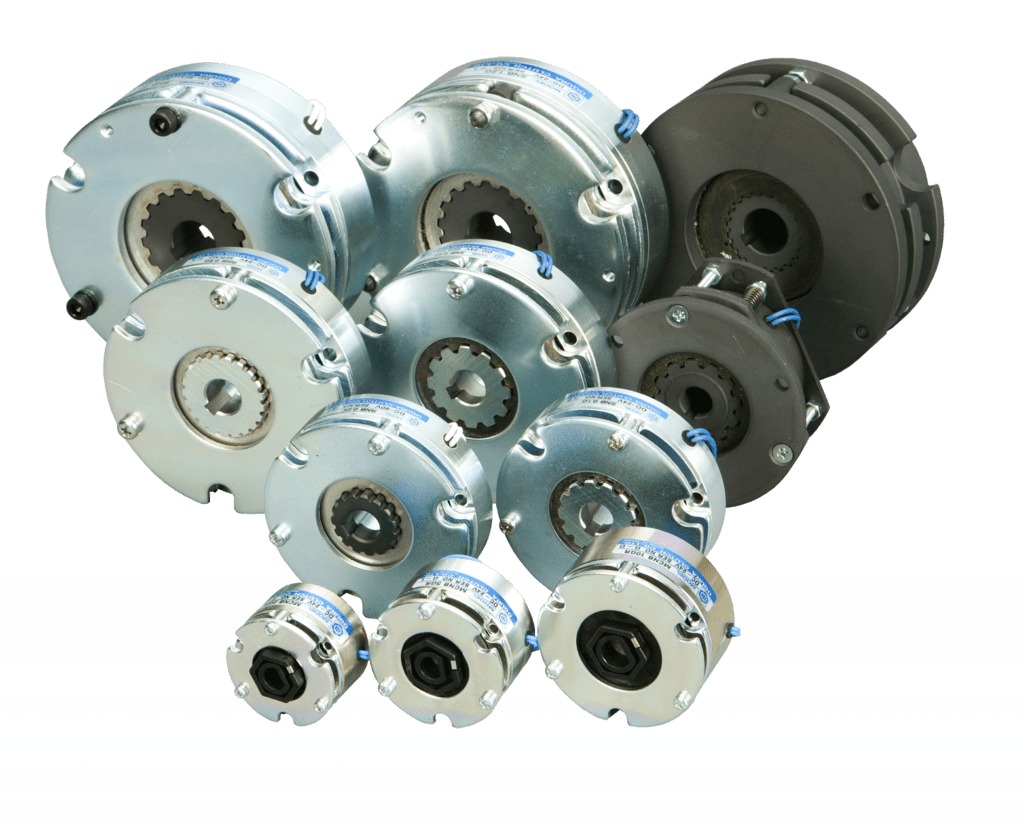

Twelve: Power-off brake cost
The focus of this article has been electromagnetic spring-applied power-off brakes. However, there also exists electromagnetic permanent-magnet-applied brakes. Spring-applied brakes are by far the more popular choice around the world — so produced in higher volume by more manufacturers, and at a lower cost. In contrast, permanent-magnet brakes are comparatively costlier but provide advantages for certain applications. They’re very torque dense, so sometimes deliver more torque for a given component size. Permanent-magnet brakes also excel in applications needing controlled stops or soft stops. This is because input power controls the brake torque.
Spring-applied brakes on the other hand are either on or off — and engagement time is very quick.
Shown here is a variety of spring-applied brakes made by Ogura Industrial Corp.
When considering a brake for a new application, it’s wise to contact the manufacturer for help in making a brake selection that best balances cost, performance, and life objectives. Another benefit of engaging the manufacturer early in the design process potential access to brake designs outside of published catalog models. Engineers who only select brakes from catalogs might miss opportunities to specify much better alternatives.
