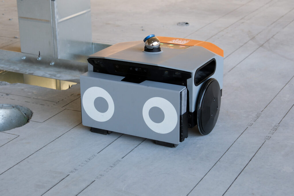

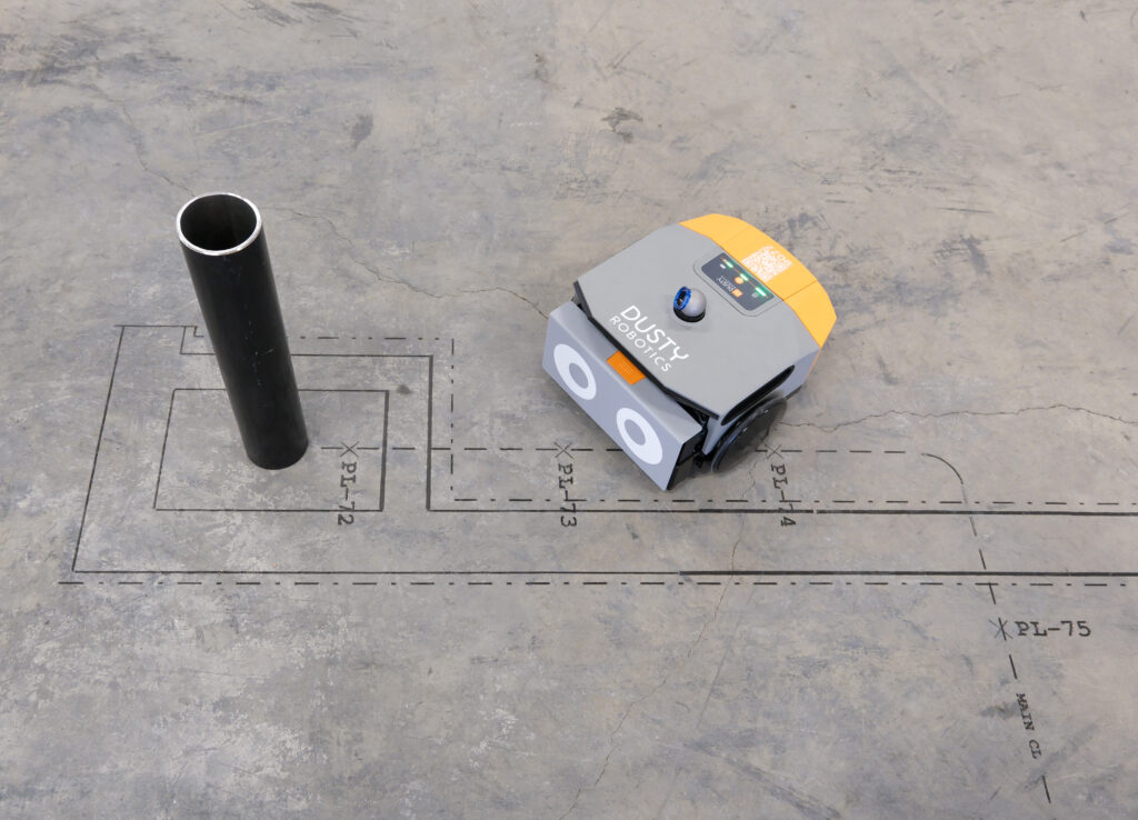

So, California startup Dusty Robotics designed an autonomous mobile robot (AMR) called the FieldPrinter 2 to independently map and mark 3D building designs onto 2D construction building floors with 0.0625-in. accuracy. With it, construction teams no longer have to constantly check their laptops, iPads, and paper plans to know what must be built and where.
Core to the AMR’s function are two off-the-shelf motion controller-drives from Performance Motion Devices — ION/CME N-series components — that provide control and power for the AMR’s two front wheels … more specifically, the two BLDC motors driving the wheels. The AMR’s rear wheel has no active drive.
Together with a suite of onboard sensors that provide precise location information (including trackers, encoders, and inertial measurement unit gyroscopes) the controller-drives position the robot. “We want continuous motion between all the objects that we print,” said Ryan Dimick, controls engineer for Dusty Robotics. The system must allow for constant profile changes as the robot switches between navigating and printing.”

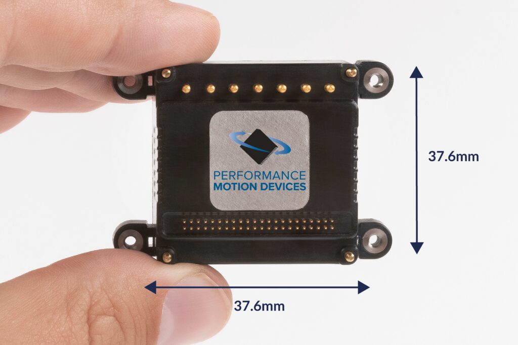

Powered by a drive and controls from Performance Motion Devices, Dusty Robotics’ AMR maps buildings designs for construction. Shown here is the ION/CME N-series motion-control drive that imparts the Dusty design with the control needed for precision automated operation. The N-Series is a compact, PCB-mountable single-axis controller that provides high-performance motion control, network connectivity, and amplification (delivering up to 1 kW of power) from a tiny 37.6 x 37.6 x 16.8 mm footprint. In fact, this is smaller than a Gen 1 AirPods case for — yet delivers unmatched function and power. The drive’s power and computing density were key reasons it was applied in the space-limited robot design.

The Dusty FieldPrinter 2 has a laser tracker that continuously reports AMR position — but often the tracker doesn’t have a view of the robot, so operation is blind. But the controller-drive (in conjunction with the robot’s sensors) keeps the AMR on track.
“When the robot is printing within a blind spot, not visible to the tracker, it’s relying on the inertial measurement unit and encoders that are coming through the controller. It’s relying on all the other sensors for five, 10, 15 seconds of continuous printing,” Thompson explained. “Then, when it comes out of the blind spot, it tells the tracker exactly where it is. We need to give that tracker the accuracy so it can very quickly and precisely acquire the signal.”
Here, sub-millisecond timing precision helps the AMR handle blind spots so common at cluttered jobsites. “That information and smooth predictable motion lets the AMR accurately estimate its location and continue printing without line-of-sight to the laser tracker,” said Dimick. This blind-spot printing is the biggest improvement of the new AMR version.
