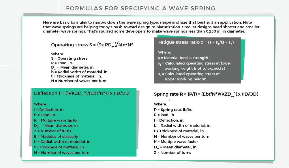

Within mechanical designs, tension, compression, and torsion springs take numerous forms to store and release energy. A wave spring is a type of compression springs made of flat wire. They are called wave springs because they have multiple waves per turn. The flat wire, along with the multiple waves per turn, combine to create the same spring force at reduced work heights compared to round wire coil springs.
Recent technology innovations in manufacturing, have led to applications decreasing in size — so the need for more compact springs has grown. A wave spring’s reduced work height (compared to that of a traditional coil spring) lets engineers shrink the overall height of the spring cavity. This often translates to a smaller assembly and potential weight savings.

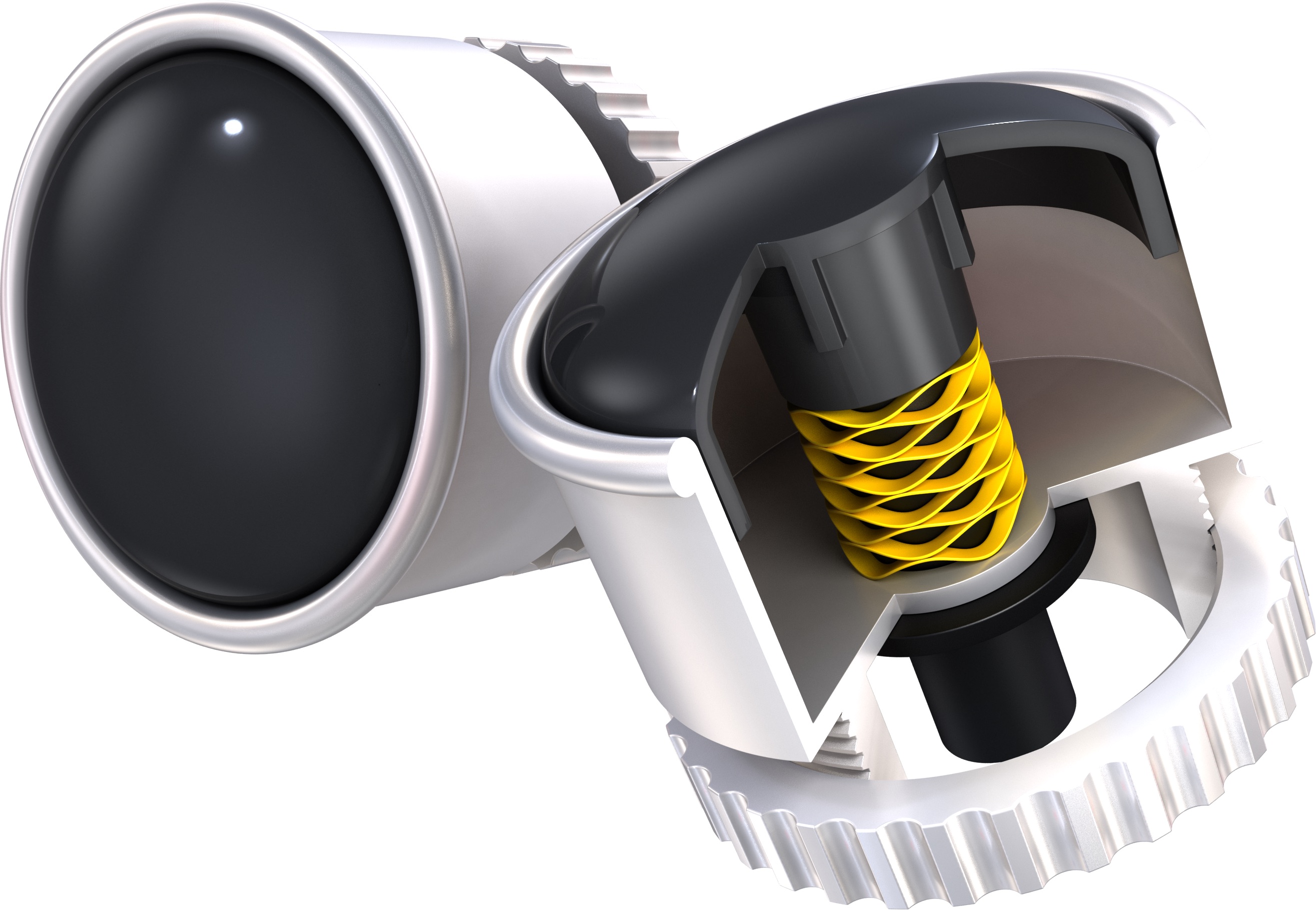

Wave springs are designed around a spring force and work height. These requirements are determined by the application. The spring can be configured to accommodate cycling or static operations. A valve is an example of a cycling application. The spring oscillates between two work heights to regulate the valve. A wave spring can also be used in a static application such as preloading a bearing. In the bearing example, the spring is compressed to a work height and remains at that height for the lifetime of the application. This reduces vibration and ultimately prolongs the life of the bearing.

The versatility of the wave spring allows it to be used in a variety of industries — including oil and gas, automotive, medical, and aerospace. Wave springs are used across these industries because they can range in sizes from as small as 0.157 in. (or 4 mm) to 120 in. or 3,000 mm in diameter.
