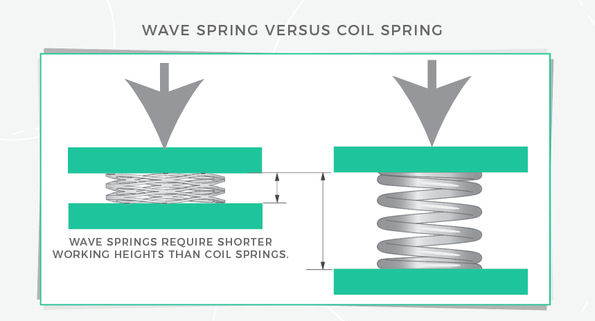

Wave springs are core to myriad gear, actuator, clutch, and consumer-grade motion assemblies. They are load bearing — included in designs to address play or compensate for dimensional variations. Wave springs apply load in axially — so are specified by working height (and other parameters).
Even at various work heights, wave springs apply consistent loads to within tight tolerances. That lets OEMs specify wave springs to very specific application requirements. Note how wave springs require less space than coil springs.
All springs are either for applying load in tension, compression, or torsion. Tension springs work for assemblies where applications rely on a stretched spring to pull the kinematic system bac to some setting. Compression springs work for assemblies where applications rely on a shortened spring to re-expand. Torsion springs work for assemblies needing application of torque.
Compression-type wave springs are by far most common. Single-turn wave springs can have overlapping ends to save axial space; nested wave springs deliver higher axial forces; multiple-turn wave springs are up to 50% shorter than a coil spring of otherwise comparable performance. What’s more, multiple-turn wave springs prevent torsional moves during compression — which is an issue with coil springs.

Wave springs install onto shafts or into areas of the assembly machined as working cavities (internal bores). Piloting grooves or other geometry helps the wave spring stays in place. Distance between surfaces inducing load defines axial working cavity — and working spring  height. This is where the spring’s material cross-section affects overall design.
More specifically, the factors dictating suitable wave-spring design include application load; bore geometry, shaft, ID, and OD; working height; and spring material to withstand environmental factors. Other general guidelines are that the wave-spring number of turns must be between two and 20; express the number of waves per turn in half-turn increments; minimum radial wall is three times wire thickness; and maximum radial wall is 10 times the wire thickness.
Reconsider working height for a moment: Designs must avoid situations that compress a wave spring to solid. That’s because as a wave spring approaches a height at which it becomes solid (with the various turns contacting or wave turns flattened) loads increase exponentially and even become unpredictable. These loads in turn can induce the spring to take a set or relax. Magnitude of relaxation depends on load and other application conditions. In any case, material deformation wll degrade spring performance.
More specifically, if a spring is going into a static application, ensure that percent stress at working height is less than 100% because springs can take a set or lose length loss under high stress.
If a spring is going into a dynamic application, ensure percent stress at working height is less than 80% because again — springs can take a set if subject to higher stress. If work height per turn is less than twice the wire thickness, the spring operates in a nonlinear range … and actual loads may exceed calculated loads.
