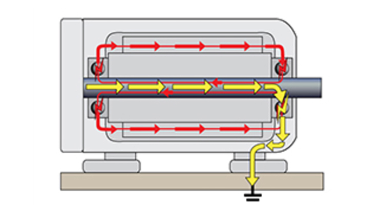

The fast switching time of the IGBTs creates parasitic capacitance, which causes capacitive coupling between the stator and rotor. This capacitive coupling induces a voltage (due to the common mode voltage caused by the drive) across the air gap between the stator and rotor. As the voltage searches for a path to ground, it travels through the motor shaft (which is connected to the rotor) and across the bearings.
Lubrication in the bearing normally acts as an insulator, but because the common mode voltage has a very high rate of change, known as dV/dt (due to the switching of the IGBTs), it can easily exceed the breakdown voltage of the lubrication — that is, the voltage at which the lubrication no longer acts as an insulator. When this happens, a burst of current is released, known as capacitive discharge current.

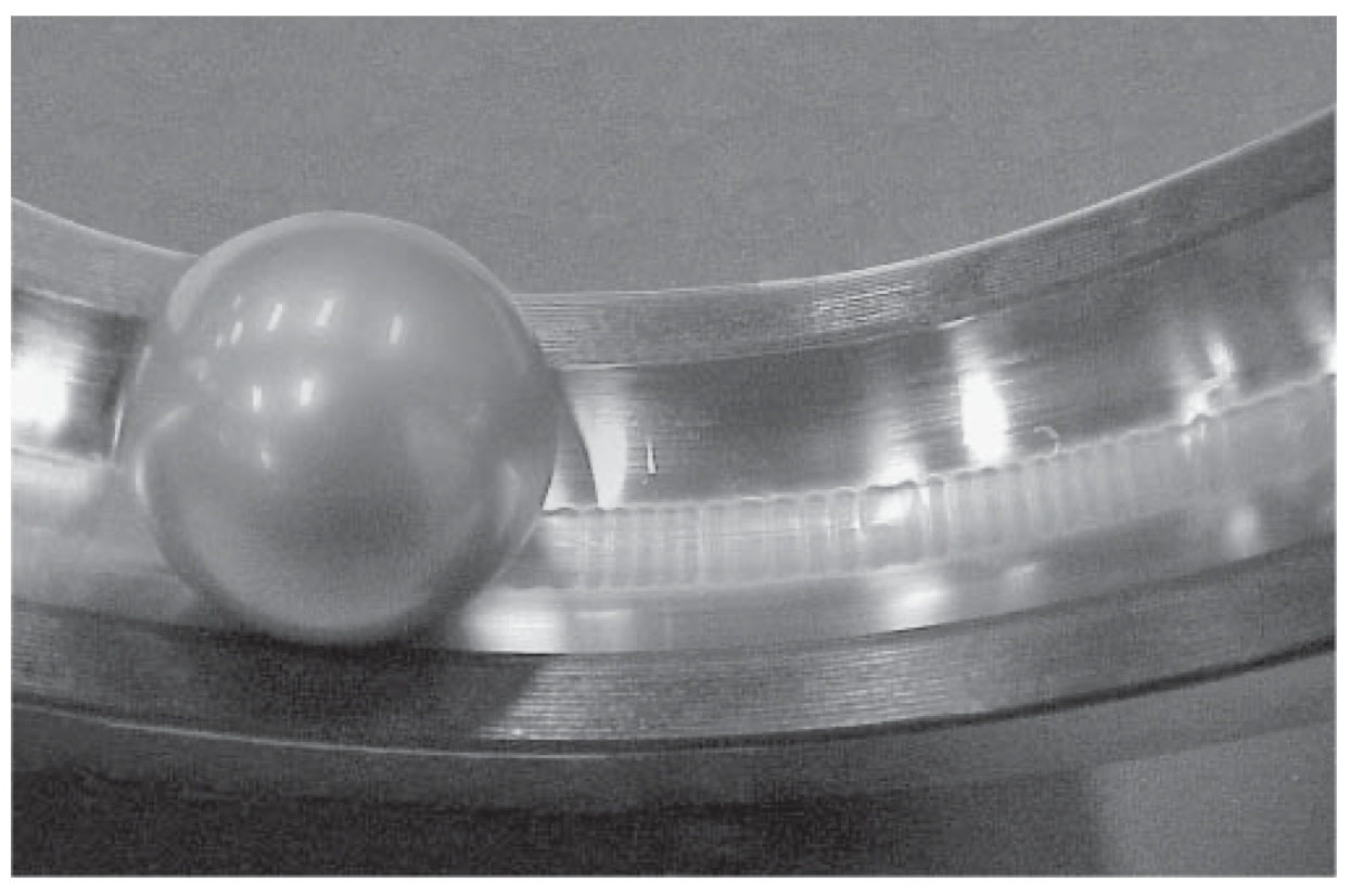

This capacitive discharge current can cause fretting of the bearing and raceways and produces temperatures high enough to melt the bearing steel and cause pitting through electrical discharge machining (EDM). This discharge can happen with every switching cycle, or at least frequently enough that over time, washboard-like ridges, known as fluting, will occur on the raceways, causing vibration and audible noise.
bearing currents
Capacitive discharge currents (yellow) and high frequency circulating currents (red) in an AC induction motor driven by a VFD.

bearing fluting
Bearing currents can cause washboard-like ridges, known as fluting, on the raceways of the motor bearings.

Common mode voltage induces common mode currents that travel through parasitic capacitances in the motor. This common mode current produces high frequency magnetic flux and currents with a frequency in the kHz or even MHz range. These currents circulate from the shaft, through one motor bearing, through the motor frame, to the other motor bearing, and back to the shaft, causing a potential difference across the motor shaft that can become high enough to exceed the bearing lubrication’s insulating properties.
This high frequency circulating current produces the same types of damage — fretting, EDM, and fluting — as capacitive discharge current. High frequency circulating currents are primarily an issue in motors over 100 hp (75 kW), with their potential for damage increasing with larger motor sizes.
