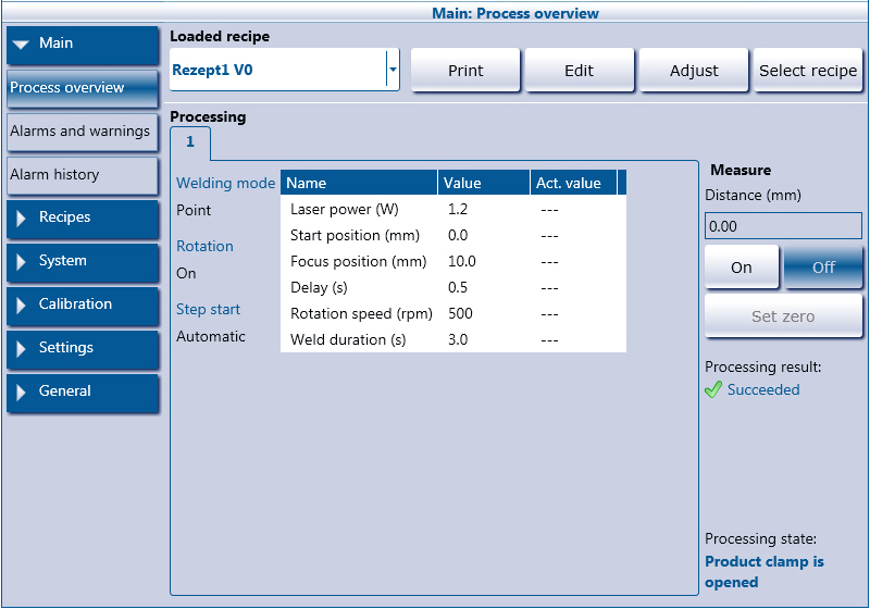

Recipes are sets of parameters that are stored in an HMI and can be transferred directly to a PLC or controller to enable fast, error-free product changeovers.
recipes example
Manufacturers can use recipes to change machine configurations or production data for different products that share the same basic components or manufacturing processes.
Image credit: BW-TEC
A key characteristic of recipes is that they contain only the parameters, or variables, that change from one product to the next. These variables can be materials such as hardware, processing steps such as whether to drill a hole or not, or machine parameters such as the depth of the hole to be drilled.
For example, if a product range consists of panels that come in three sizes — 150 x 150 mm, 300 x 300 mm, and 450 x 450 mm —and each panel size is assembled using different screws, recipes could be used to specify which screw size to use with which panel size. Similarly, an inspection operation that tests the torque of the assembly screws could use recipes to specify different torque values for different screw sizes.
Most HMIs include (or can be configured with) a recipe feature, which allows recipes to be created, modified, saved in a database, and uploaded to or downloaded from a PLC or controller. Recipes are often created and managed in a spreadsheet format, and the recipe data can be imported and exported — typically as a CSV file — between the HMI and a USB drive or SD card, making it easier to modify the data using a program such as Excel or a text editor. And some HMI recipe functions allow recipes that have been modified in the PLC or controller to be uploaded to the HMI as a new version and saved to the recipe database.
Although HMI manufacturers use different terminology for the elements of a recipe, every recipe consists of a “master” recipe, which contains all the variations of the product. For example, the master recipe for the Panel Assembly described above would contain three recipes: one for Panel 150 x 150, one for Panel 300 x 300, and one Panel 450 x 450. The recipe data — the specific screw sizes used for each Panel recipe — are associated with HMI tags where the data will be stored.
