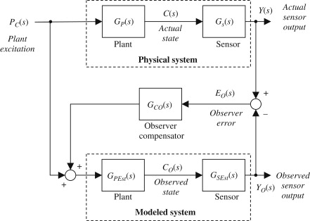

A common observer model used in motion control is the Luenberger Observer, which uses models of the plant and the sensor in parallel with the physical plant and sensor.
In control theory, the plant is the system that takes an input and produces an output. In servo systems, this is typically a servo motor driving a mechanical transmission component such as an actuator.
The output from the plant and sensor model is the observed output. But even the observed output contains error, because the models are not perfect representations of the actual plant and sensor. So the error signal produced by the observed output is routed back to the model through the observer compensator — which is typically a common PI or PID controller — to further reduce the error in the observed signal. This way, even small errors in the model are corrected, and the observed state of the plant becomes a good representation of the actual plant. Now, the observed state can be used to close the control loop of the actual plant.
observer
The Luenberger observer combines the sensor output, Y(s), the plant excitation, Pc(s), a model of the plant, GPEst(s), a model of the sensor, GSEst(s), and an observer compensator, GCO(s).
Image credit: G. Ellis, Control System Design Guide
The observer model can be created with lookup tables (comparing known input values with known output behaviors) or with an algorithm describing inputs versus outputs. During auto-tuning, the observer makes corrections to the model, and during normal, closed-loop operation, the observer uses the model to make corrections to the control loop.
