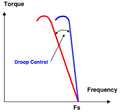

For applications where load-sharing needs to be precise and controllable, some AC drives include a function — typically referred to as droop control — that manipulates motor slip to better ensure equal load-sharing. Here’s how it works:
droop control
Droop control effectively shifts the motor’s torque vs frequency curve so that an increase in torque causes a decrease in the drive’s output frequency.
Image credit: Schneider Electric
The drive monitors the motor torque (via current draw), and if the torque increases beyond a set value (indicating that the motor is taking on too much load), the droop control function decreases the output frequency of the drive.
The rotor speed has slowed due to the increased load, and the decreased output frequency from the drive causes the stator magnetic field to also decrease in speed. Hence, there’s a smaller difference between stator speed and rotor speed. In other words, slip is reduced, which reduces the motor’s torque production, allowing other motors to take more of the load.
Droop control can work both ways — reducing the output frequency of the drive when the load increases (to decrease the amount of load on an overloaded motor), or increasing the output frequency of the driven when the load decreases (to increase the amount of load on a non-drooping motor). This two-way method of controlling load sharing is sometimes referred to as “bipolar” droop control.
