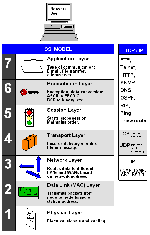

Ethernet is defined by the IEEE standard 802.3 and specifies the physical and data link layers of network functionality. TCP/IP is a suite of protocols used on top of the Ethernet data link layer that enable communication over Ethernet. TCP is the transport control protocol, which ensures data packets are delivered completely and error-free. IP is the internet protocol, which routes data packets based on their IP address.
Industrial Ethernet
A network protocol stack consists of multiple layers, each of which deals with a certain aspect of data transmission and management. Industrial Ethernet is based on the physical and data link layers of standard Ethernet, with certain modifications, including – in some cases – different transport and application protocols.
Image credit: PCMag Digital Group
Industrial Ethernet refers to a set of Ethernet protocols that are based on the standard Ethernet hardware (the physical and data link layers) and internet protocols (networking and transport layers), together with a proprietary application layer. The application layer protocol ensures the correct data is transmitted and that it’s received when and where it’s needed for a specific operation.
